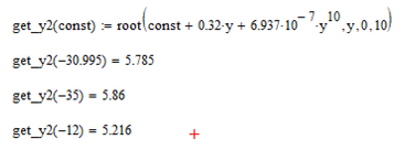

I am not sure if I understood correctly what you are finally after. You want to change the constant (-30.995) and pick the real valued solution (possibly the positive one). If thats true, you might as well use a solve block which you can turn into a function of that variable constant:
And if you know for sure that the seached for values always are, lets say, between 0 and 10, you may even use the "root" command for the task.
Worksheet attached (in Format MC11)

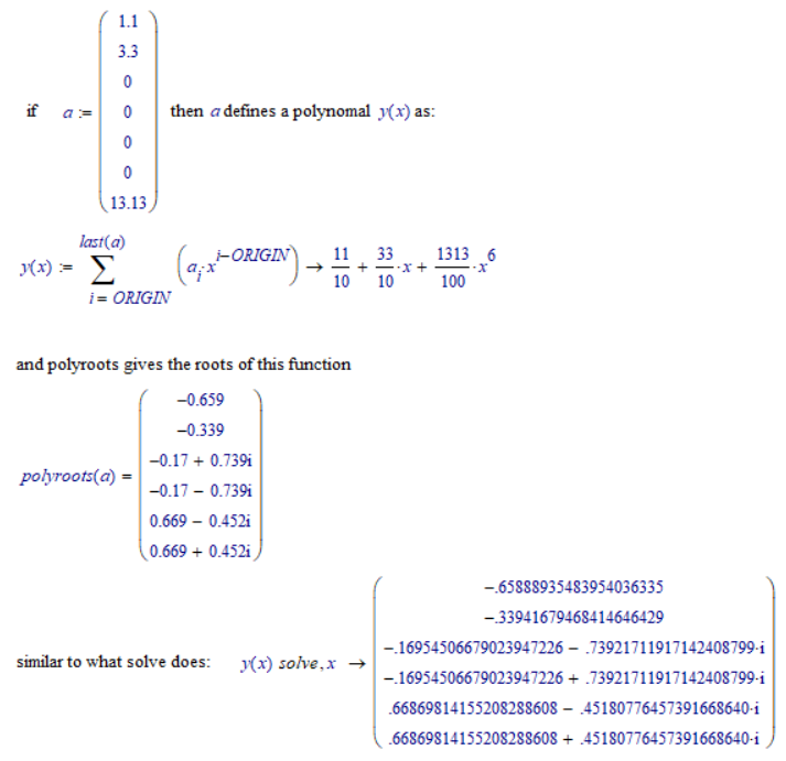

I can't read your file. Does this help:
Note that when your dynamic range is big (large ratio's of coefficients) it may be wise to choose the best algorithm. Select the polyroots function, press the right-mouse button and select between LaGuerre (default) and Companion Matrix...
