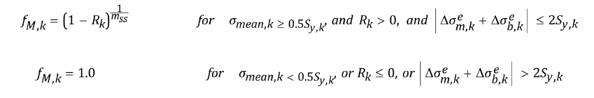

Dear all,
How can I set this programming function in mathcad 15?
Regards
Stefano

The general structure of a conditional program in Mathcad is something along the lines of ...
Here I've simply used the catchall "otherwise" (equivalent to "else" in many other programming languages) rather than type in the whole of that expression.   A word of caution here ... you have to be careful to make sure that your conditional catches all of the possible outcomes - in this case, you'd probably want to use another "if" statement for the second case and an "otherwise" to trap anything that didn't meet these two conditions.
The specifics of how you implement this equation depend upon the exact nature of your expression. Is f a function of the two arguments M and k? Or is f a matrix (tensor?)?.  If your Delta-sigma with the parameters e, m & k is meant to be a tensor, then your first problem will be deciding how to represent the data in Mathcad, as there is no inherent Mathcad support for tensors - a nested array may be the way forward.
More details on what the expressions mean would be helpful.
Stuart

The output value must be only a number (not matrix/tensor etc..) M and k subscript are only for  definition value (is a coefficient used in mechanical fatigue analysis and k indicate a stress state).
In this case the previous expression is correct? In your expression how can I obtain the following symbol?
and how can I insert "," in the subscript?
This  symbol (symbol.png) what does it indicate? and?

OK.  However, without some background on the notation, I can't offer much more guidance - notation, particularly domain-specific notation, can be difficult to interpret (eg, I'd have put good money (maybe as much as 0.01 euros) on this
being a tensor ("e" being italic makes it seem like it's a variable rather than the mathematical value 2.718281828459...
Do you have a reference to a website or pdf document that explains what you want to calculate?

this is an extract of ASME VIII div.2 Fatigue procedure (I can't reported the complete procedure, but I think that this extract permit to understand).
the k notation is refering to the k-th cycle.
In a simple case of cycling beetween max and zero value k is 1 because there are not another cycle condition.
