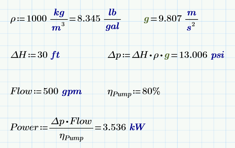

I am working on some calculations templates for my daily work related to centrifugal pumps and pumping systems. I am having difficulty in developing a template that can display units in imperical and or metric units using normal industry standard formulas. I can fake it with MathCad but it does not look professional. Can someone provide me tips on the best way.
Example Equations:
1) Pump Brake Power (bop) = (Head [feet] * Flow [gpm] * SG) / (3960 * Pump Eff [%])
2) Pump Pressure from Total Dynamic Head and SG [Specific Gravity]: Pressure [psi] = (TDH [ft]* SG)/2.31

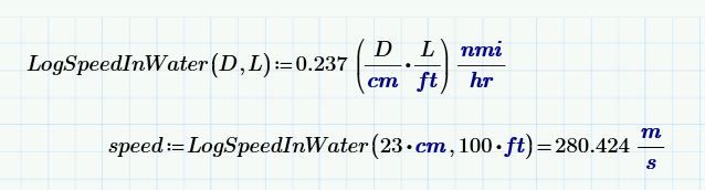

5) I have several very special proprietary (secret) imperical formulas that have been developed through testing and their units cannot be rationalized. I would like to develop a method for using this equation.

1)
Well... that is awesome... got it.  Just need to think different.  Thanks.
Easy say your imperical formula was for speed of a log in a river based in diameter in cm and length in feet then
gave the answer in knots.   Once the definition is made you can enter D in imperial or metric and it is converted to cm internally to suit the units of the empirical equation.
