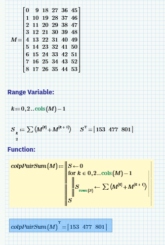

Do you mean something like shown below?
It should work for any matrix with an even number of columns.  The above is written in Prime 7, but the M15 equivalents should work.
Stuart
Stuart

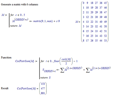

Slightly different implementation that is ORIGIN independent:
