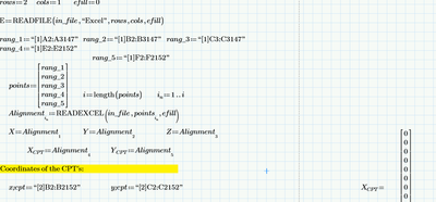

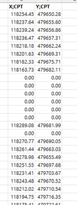

Hi there
I using (READEXCEL) but it read all the values as zeros
they should be these  values
It works with the previous values
thanks in advance

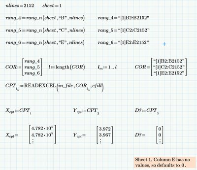

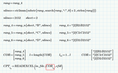

Is the Excel worksheet up to date?  You call Sheet 2 in your Mathcad worksheet, but in addition to the lack of Column D, there is no Sheet 2 in "Total Original Location.xlsx".
I modified your Mathcad worksheet to construct the range from the sheet number, column letter and number of lines; I also modified Sheet 1 to include a Column D (scaled copy of Column C).  I didn't see any errors when using Sheet 1 for all valid ranges.  I then changed rang_6 to point to the empty Column E and got a vector of zeros (as expected from an empty column).

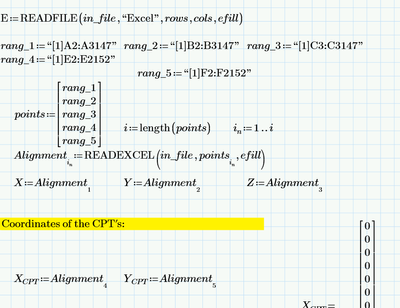

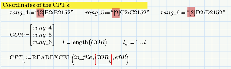

I changed that , however it wasn't saved ... range 4 is in the first excel sheet , but I'm getting zeros in mathcad
also in the one below ... it is writen bad sheet what does that mean?
Haven't you read what I wrote more than 3 hours ago in my first reply and what I repeated in my last one?
Your Excel sheet contains only three columns of X,Y,Z data - nothing more!. There is no CPT data stored in the file. There is neither a second sheet nor a column D, E or F!!!!
Or better said, of course there actually are column E and F, but they are empty and contain no data. So Mathcad reads zero values there.

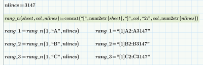

BTW, if you're interested, here's the rang_n Excel range builder.
This saved me a lot of typing and rechecking ranges when I switched sheets and columns to examine what was happening.

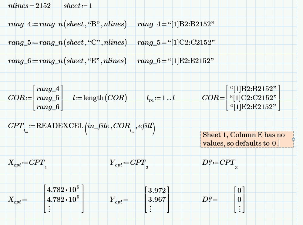

Initial Sheet 2 that doesn't exist:

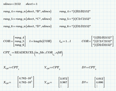

Change to existing Sheet 1 with data in Column 😧
Change to Column E that has no data:
Lots of typing upstream, but far less when changing the ranges.
