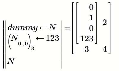

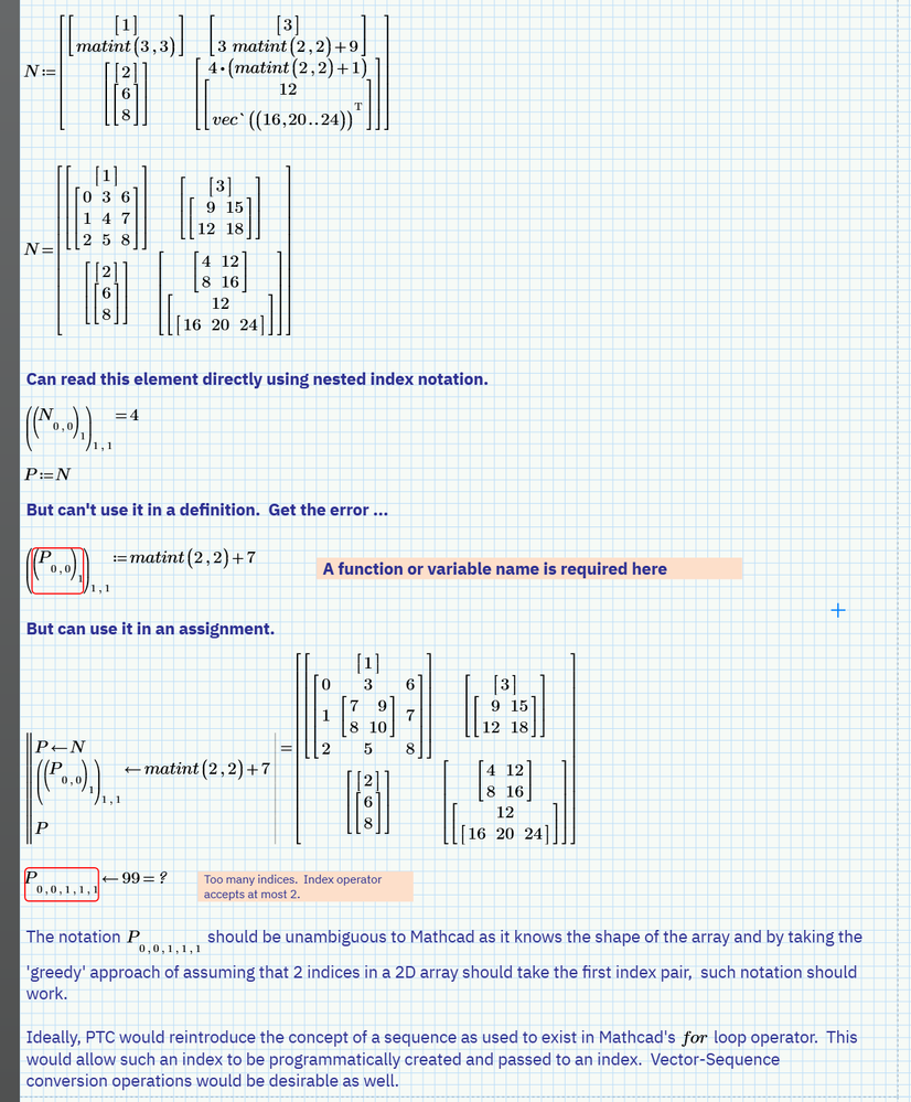

Your Werner railings.jpegs are possibly what I might have seen, but forgotten about.  Apologies if so; my memory is as bad now as it was then.   Although I have a very vague recollection of seeing this when I was modifying my multidimensional array worksheets to work with Prime Express.
Whilst PTC are fixing this indexing feature, it would be nice if they'd give some consideration to fixing two particular bug bears I have with the normal indexing notation.
  • Cannot use deep nested array indexing on left hand side of a definition, although it works in an assignment.
  • Programmatically and visually, nested indexing, whilst unambiguous, isn't flexible enough to cater for irregularly shaped nested arrays.  The ability to use a single level indexing would make it easier to see the indices and to handle deep arrays.
ISTR that you couldn't use nested indexing in an assignment, either.  Did M15 or early versions of Prime allow it?

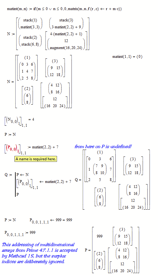

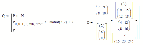

(To:StuartBruff)
Here is what you did converted to Mathcad 15.
StuartBruff
(To:Werner_E)
Interesting.
What do you get if you use P0,0,1,1,1 inside your Q program?  I presume it also ignores the extra indices, but given that local assignment works while definition doesn't, that presumption is just guesswork.
Prime telling you it won't have anything to do with more than two indices is better than quietly ignoring them.
Stuart
(To:StuartBruff)
@StuartBruff wrote:
Interesting.
Correct. MC15 ignores everything after the first two indices, not even checking if the variable used is defined or would be valid integer.
Agreed on, yes.

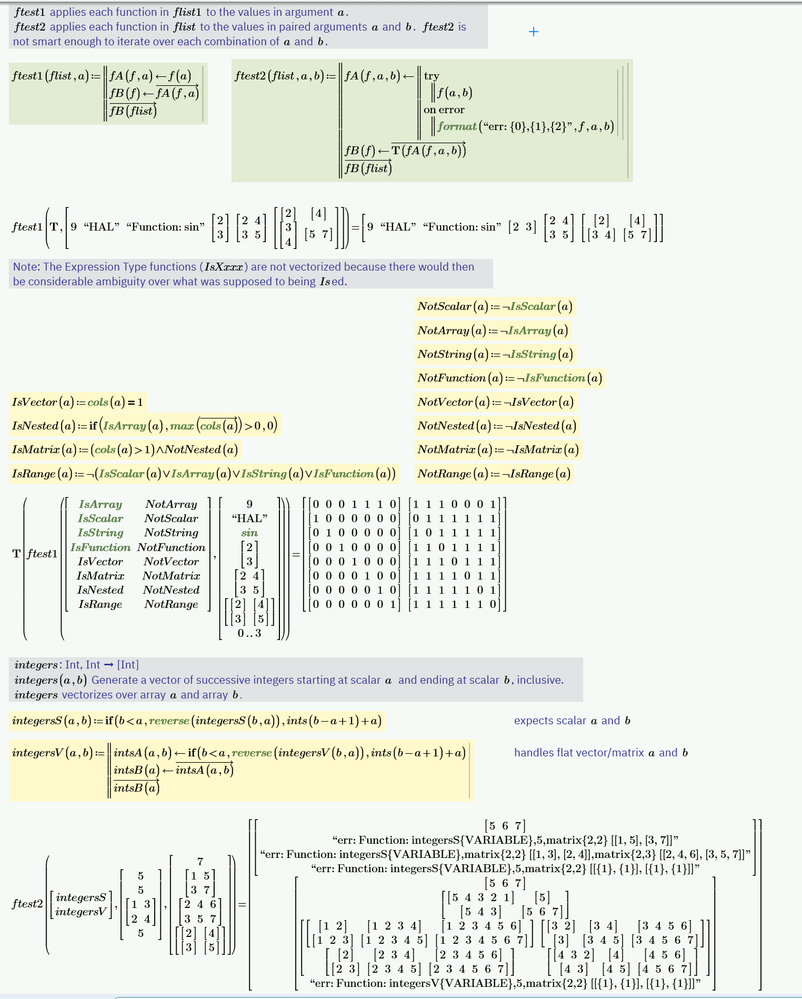

I'm afraid I find implicit vectorization to be more helpful.  Explicit vectorization requires a bit of thought as there may well be array arguments that shouldn't be vectorized when calling them or are of different sizes to the main object of the vectorization. This requires me to think about and implement the same process each time I use explicit vectorization - but thinking makes my brain hurt, and thinking just the once is bad enough.
For example, I often use implicit vectorization to allow a notionally non-array argument to be overloaded with an array as well.   By transferring the vectorization to a function, I have more and consistent control over what gets vectorized and how.
Great care with vectorization, one must take.  Things nicely to do, always possible it is not.  Which is why a map function,  sometimes I use. Or even (gasp!) to ugly explicit iteration, resort I do.

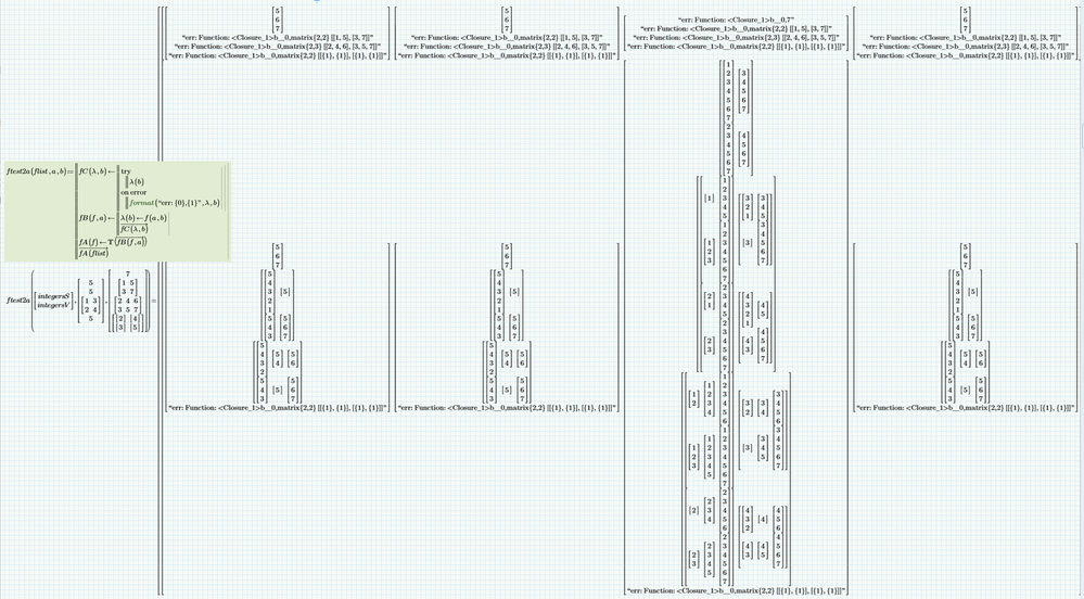

StuartBruff
(To:StuartBruff)
Of course, sometimes one must be careful what one vectorizes for ...
Stuart

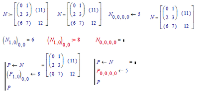

LucMeekes
(To:Werner_E)
Mathcad 11:
Errors:
- The expression to the left cannot be defined.
- This array has too many subscripts.
Incidentally, it is possible in Prime to (re-)assign an element of a nested array:
You can even create new elements:
Mind that, like the 'function' notation of indexing, the update1 and update2 functions use ORIGIN=0 irrespective of the value of ORIGIN.

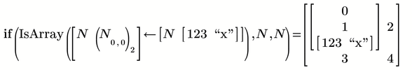

Ah yes, thank you, I had completely forgotten about these undocumented functions. So now it's up to us to decide which way of writing seems more appealing and intuitive and whether we are prepared to use undocumented functions ...
It seems only to be mandatory that in he program the global variable N is used on the right hand side of any assignment before we can use it in the desired way.
I dimly remember that we had something similar here some time ago, but I have no idea what it was all about. 😞
Here is a tense one-liner
and, no, I won't call it appealing and/or intuitive 😉

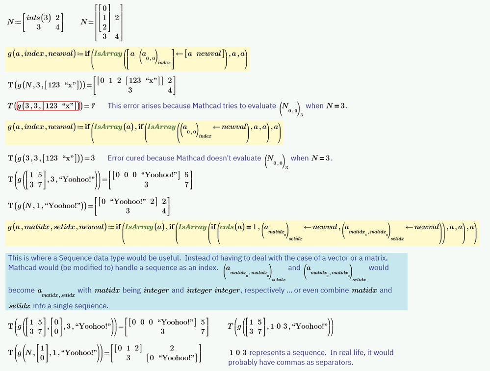

StuartBruff
(To:Werner_E)
That's so ... specific.  😱  Instinct forced me to generalize it as a function.  But both you and Greenpeace will be delighted to see I didn't implicitly vectorize the function.  😊
Life would be so much easier with a decent Sequence data type.
