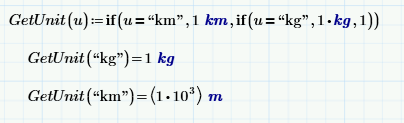

Here's an example of the effort requred to get units (from an additional excel column) over to Mathcad:
As you can see, most of the work is in the GetUnit() function, and it will be a lot of if-statements if you want to be prepared for all possible units...

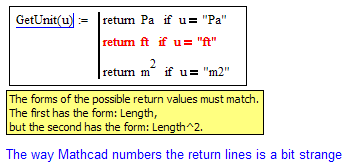

Additionally to what Luc had written, you have to be aware that a routine like his GetUnit will only work OK with units of the very same dimension - in case of his exemple units of lengths. A Mathcad function unfortunately is not able to return values of different dimensions depending on an input argument.
LucMeekes
(To:Werner_E)
That depends on the version of Mathcad. In Mathcad 11 and before this is not a problem:
This functionality was broken with Static Unit Checking (Mathcad 12?) and it still is impossible in Mathcad 15 if I'm right. In Prime it's possible again:
The problem in Mathcad 11 (and versions before and after) is that you cannot have mixed units in an array. That's possible in Prime too. This is one of the few areas I think where Prime is superior to Mathcad.

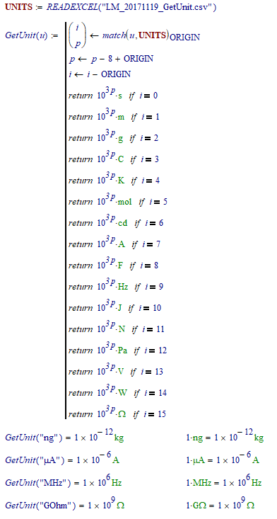

To work seriously with units, you could implement this function in Prime:
You'll need the attached .CSV file with it.

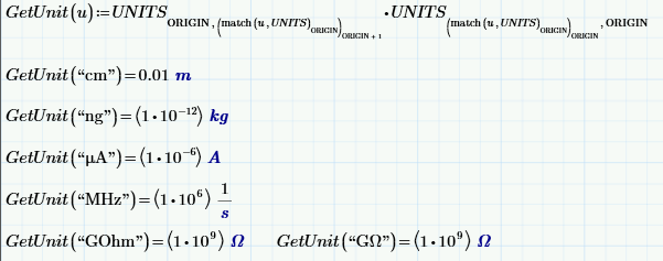

Ok, Here's the function for Prime (4.0). It works in Express Prime, thanks to the fact that Prime allows mixed units in an array or matrix.
Corrected, the atto's need to be in between the zepto's and the femto's
The Prime file is corrected.
Also added genuine Omega's, next to Ohms.

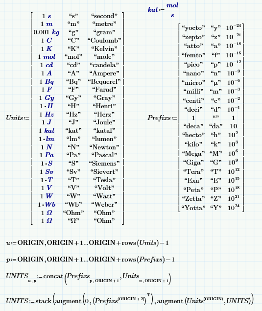

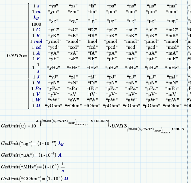

Revisited for a more generic solution.
This should cover all SI units.
The above is to create a UNITS table.
The GetUnit() function definition and a few of its usage examples is below:
And the file attached contains the Prime 4 stuff completely.
