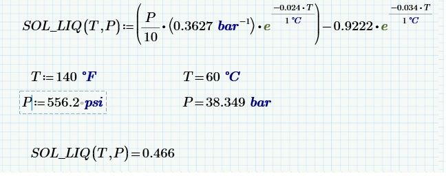

I tried to define the function so that all the units of measure would cancel out and one would produce a dimensionless mass fraction but MathCAD thinks I am doing it incorrectly.
Please explain what I am doing wrong or provide a workaround.
Thanks!

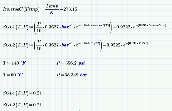

Yours looks like it should work. But you can try this:
°C is actually a function that converts your input to a temperature. Mathcad has to treat °F and °C differently than the other temperature units because they are not zero-based (not sure this is the right terminology).
Because °C is a function and not a unit, you cannot just divide by °C. You need a function that gives you the inverse temperature. You can write your own function like this:
Or you can see another option here: https://community.ptc.com/t5/PTC-Mathcad-Questions/Inverse-Temperature-Units-in-Prime/m-p/347471#M135794
Here are the two options implemented to your function:
(Mathcad 3.1 attached)

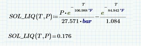

Please Werner, I'm sorry, my German was somewhat rusty, and I've done a bit of confusion. I learned German from self-taught, with grammar and vocabulary, late seventies and early eighties I was in the former BRD. In 1981 I was in Mannheim, there I found a woman, by the "Juonoesqe" beauty, that I could no longer work ... So after a while I returned to my country.
Regarding the problem, I get the same result with mathcad 15.

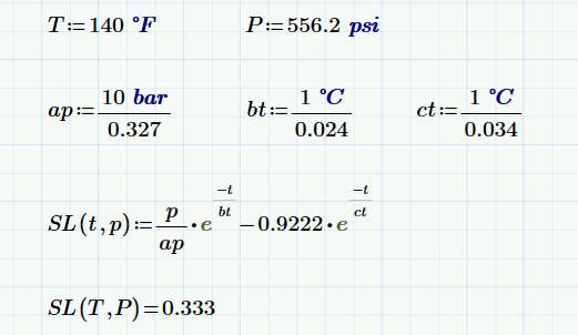

But if I write the function in slightly different form, I get a different result:
What is the right solution? The last?
@-MFra- wrote:
If I write the function in slightly different form, I get a different result:
But still a wrong one. As MJG already explained here e few days ago, you can't get rid of the unit °C by a simple division - you need to perform a shift, too. MJG already had shown two ways how to do it and the result using the values the OP provideds is around 0.21.
