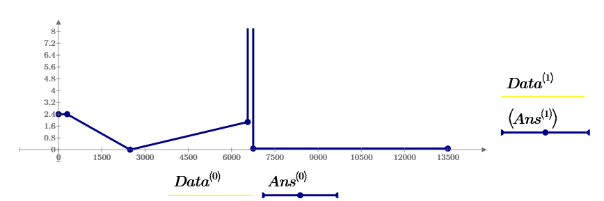

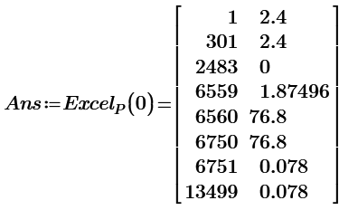

Programming lesson of data set.
From csv Data, programming makes Power Table data Ans as shown below.
But this is only for this data set and if the data has noises it becomes more difficult.
Therefore, this is only the first step to make table data.
Tokoro.

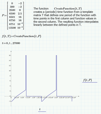

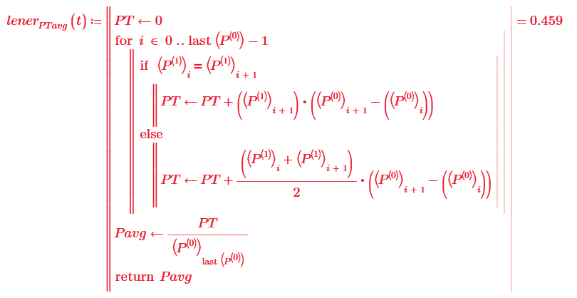

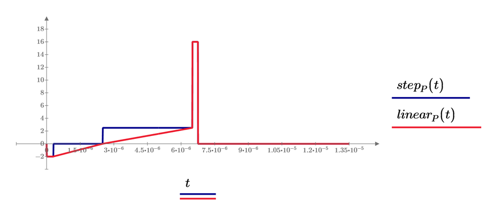

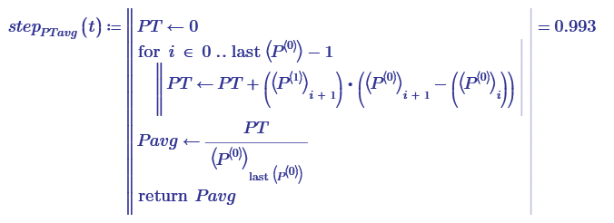

LucMeekes
(To:Jacob_S)
I guess this is sort of what you are looking for:
Attached is a Prime 4 file.
Jacob_S
(To:Jacob_S)
This is great job...
I was expecting a little bit more simpler solution where range variable s splitting different sections in the plot as per matrix and then combining these sections in the plot , after that find the average from plot...Once again thanks a lot for helping. Corrected matrix included
