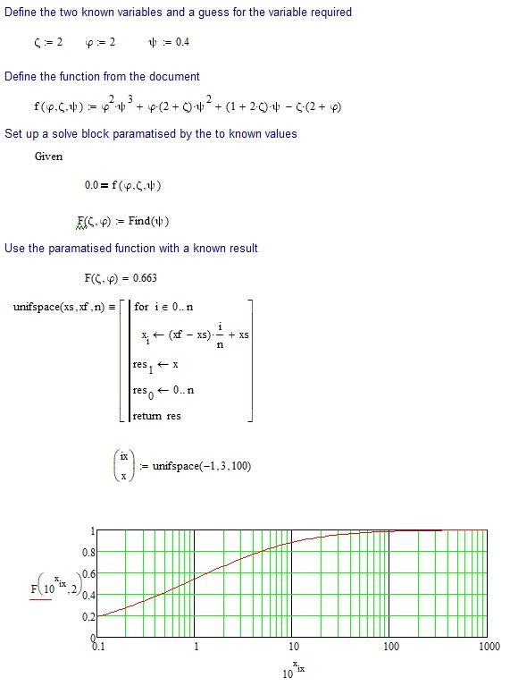

I fired up another machine that has Prime 3.1...
You should be able to continue from here.
Prime 3.1 file attached.

Or do like this:
(Created in Prime 4, file attached, but you cannot open that in Prime 3.1)
I suggest you recreate the sheet in your Prime 3.1.

First off: do not just post pictures. Post worksheets.
Second: I say there's an error in your definition of the F() function. In the second term one of the two phi's should be psi.
Last: did you try to reproduce my first solution? And what does it give?
P.S. Even though the function definition is wrong, a solution is still found by Mathcad 11. But the result is quite different:
I guess Prime (with mupad) is not powerful enough to solve it.

This is what you produced, with errors marked:
Do not put an =0 at the end of the definition of f().
You are mixing up the psi's and the phi's! Check your definitions, and compare to my sheet.
Finally you need to vectorize the expression to plot.
You may want to set the horizontal axis to a logarithmic scale...
P.S. You cannot just paste a picture into the text on this forum (well, you can, and it looks great, but once you submit the post, the picture is replaced by an icon).
To insert a picture in the text (like the one in this post) you HAVE to have your picture  saved as a file (.png, .jpg, or the like) and use the "Photo's" button  just above the edit window and follow the instructions.
Other than that...whenever possible always attach the Mathcad/Prime sheet.

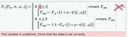

As pe your snap given, I did the same but wondering its throwing an error for variable "n". However at top right, I am already defining "n" but still it says "This variable is undefined..."
Have a look at below snap:
Additionaly, calculating Ft as wihtout function of other variables, it is producing the result. Highlighted in above snap.

Attach the worksheet... NOT just a picture.
(To:ygupta)
Don't use a numeric evaluation when you define a function!
If Ft is defined as a function you need to use it as a function not just put the equal sign after it

And what if n is inbetween 1 and 2?
Hi Luc,
n is a whole number representing the number of connectors it never should be input as a number between 1 and 2
