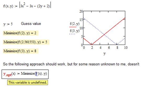

I can confirm that "Minimize" does not need a solve block to work (if you don't have to apply additional constraints) and that even in combination with the usually quite beasty absolute function should work.
You had used the wrong syntax. For a single argument function f(x):=... the syntax would be minimize(f,x) and NOT minimize (f(x),x).
In real Mathcad (as opposed to Prime) we can define a single argument function by simply using the two argument function and providing just the first argument. See the screenshot. All works fine with constant values of x.
But when I try to turn that into a function, Mathcad moans about f not being defined. It should work but the Minimize function sometimes is beasty, too. The really annoying part is that I think I solved a similar problem quite a long time ago but simply can't remember how 😞
Setting the first derivative to zero can't work in case of your function as the derivative is NOT zero anywhere and your function is not differentiable at the position in question anyway.
Using root the find the point of  zero works in your case, but of course would fail if the function is changed to something like f(x,y):=| .... | - 5

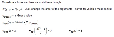

OK, got it!
Sometimes its really easier than thought at first.
The trick is to exchange the two arguments:

Thank you so much. I tried this approach and it works!

(To:Werner_E)
For some functions a single guess value y.guess might not be appropriate for the whole range of x-values of interest. In this case it might be a good idea to make the guess value dependent on the argument x and add it as an additional argument of the y.opt function.
The example below shows how to do it and also uses a slightly more complicated function f.
