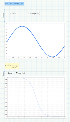

The 'Chart Component' plot assumes an X range of -10 to 10.  When I zoom in on a plot, it doesn't recalculate so Delta-X doesn't change.  Curves are sometimes longer smooth (example below).  It seems like there should be a way to recalculate a plot after zooming in, but I don't see anything.  Am I missing something?

Sure, here's f(x)=sin(12*x).  I let it default to the x=[-10 10] and zoomed in.  I've also attached the file in Prime 10.  It's not surprising that the resolution is bad when I zoom in.  Is there a way I can get it to recalculate?

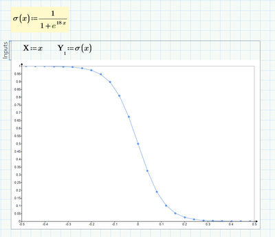

I was just about to post that I'd seen the problem.  I used the sigmoid function to get a sharpish bend.
I've had a quick play, but I'm afraid I can't see any way to get the Chart Component to increase its x-axis resolution.
Apart from changing the x values outside of the Chart.
