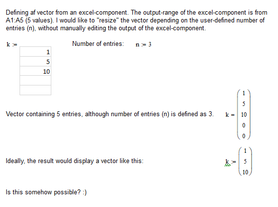

I have a problem that i hope someone here have a solution for - see below (also attached).

Use the submatrix() function; look that up in the help.
Example:
