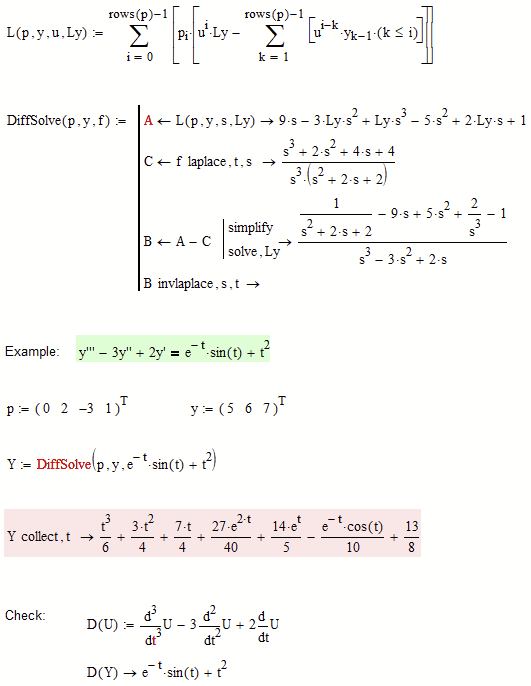

I guess the book you referred to is "Calculus and Algebra with Mathcad" by Byrge Birkeland. There was a version of the book for Mathcad 8 from 1999 and a later version for Mathcad 2000. Not sure if the MC8 version already included that chapter (4.3.2).
Anyway, here is a modified version of the described method which also works in Mathcad 15 (it will not work in Prime). As in the original version, the independent variable must be called "t" - this is mandatory!

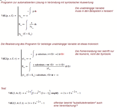

A long time ago I played around with the idea of writing functions to solve ODEs automatically in Mathcad using integration, but I only finished /to some part) linear first order ODEs and never took time to extend the method at least to second order ODEs (which I guess should be possible), let alone systems of ODEs.
As far as I remember, it was particularly tricky to find a way to use arbitrary names for the independent variable so as not to be set to just x or t.
In case you are interested and like to work along I attach the file. The comments mostly are in German but I guess you'll get the idea how to use the functions.

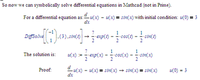

Heureka! Persistence sometimes pays off!

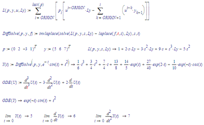

Great!
In Mathcad 11 the construct with k<=i fails. As soon as I put that in, the function L forgets about the initial conditions, they're all set to 0.
Since its use is to limit k from going above i, this can also be accomplished by the upper limit of the inner summation. I also observed that the L function is not ORIGIN aware.
It appears that I can compact the DiffSolve function to a oneliner.
The result is:

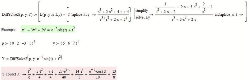

The one liner sure is possible only in MC11 but not in MC15.
The construct with *(k<=i) is necessary in MC15. I am not sure why, but the symbolic in MC15 seems not to like the "i" as an upper limit of the second sum.
The error message when trying to symbolically evaluating L(..) is "assumption impossible (property::Null)" ????
Otherwise your implementation would sure be more elegant and preferable. And yes, I agree that L should be written ORIGIN-aware 😉
(To:Werner_E)
BTW, here is the one-liner which works in MC15, but its ugly and confusing looking
and because of the various symbolic evaluations it "grows" and always shows the intermediate results of the last example it was used for:
I would stay with the four-liner I posted before, using an ORIGIN-aware function L, of course

(To:Werner_E)
Hm Werner,
did you check your L function with an ORIGIN other than 0?
I think it should go wrong. The power of u, just before Ly, needs to start at 0, independently of the ORIGIN, so you should subtract ORIGIN from i there...
Then, you say this does not work in Prime.... have you tried? (What limits Prime from doing this?)
(To:LucMeekes)
You are absolutely correct - what I showed in the pic would not work OK with an ORIGIN other than 0. u has to be raised to the power of i-ORIGIN and not just to the power of i.
No, I didn't give it a try in Prime because I know that PTC has limited the use of symbolic evaluation there.
You probably know that solve block can't evaluated symbolically anymore in Prime.
What would make my sheet fail in Prime is the fact, that Prime does not allow symbolic evaluations inside of a program and my approach heavily relies on doing so (three times, because the first evaluation of L(..) must not necessarily be done).
Symbolic evaluations inside of a program are a bit tricky in real Mathcad, too. We need to type the expression with the symbolic evaluation at some space outside of the program and have to copy and paste that expression to the program we are about to write. Trying to add a symbolic eval directly when writing a program would result in a symbolic eval of the whole program, which would not do the desired job.

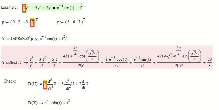

I understand that the relationship for A:
is deduced from ODE:
But how do you deduced/reached the relationship for C:
B.JPG???
Case 1:
Case 2:
Why the result is different?

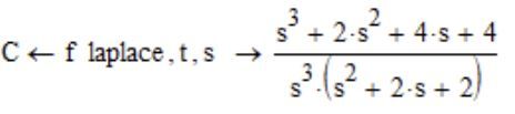

(To:Cornel)
C is the laplace transformed of the source term function f
I simply splitted Birkelands second program line into two, because Mathcad 15 does not offer a laplace function, only symbolic evaluation using the laplace keyword.
As shown in my last answer its possible to create a one-line function in Mathcad 15, too, but the multi-line version is much more clearer, I guess.

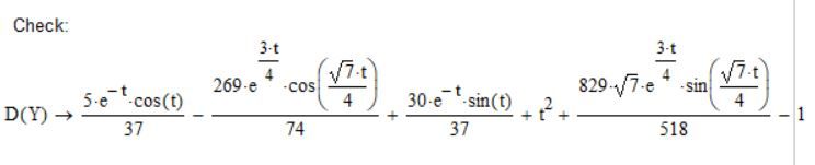

According your case 2:
If you change the coefficient of the third derivative, you also have to change it in the "check-function" 😧

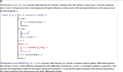

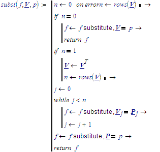

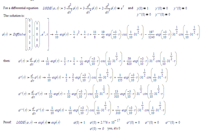

Anyway, Number 1 is solved (for Mathcad 11), using a symbolic substitute function originally from Tom Gutman (in his file xx(1186) he named it Rep), which I adapted to be a little more versatile:
With that, the symbol for the independent variable in f is changed to t_, and finally in the result t_ is changed back to the independent variable name supplied as an argument to DiffSolve:
This allows me to:
or
or even:

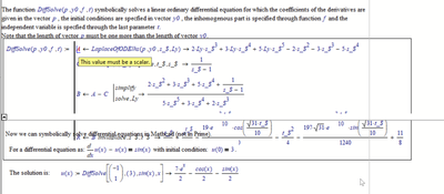

Here is the DGL1O file in format MC11
LucMeekes
(To:Werner_E)
DGL10 doesn't fully run in Mathcad 11. Hope there's no need for it to.
I've tried my best to convert my LODEsolver to meet Mathcad 15's requirements.
So now it doesn't run in Mathcad 11, but... Does it run in mathcad 15?
If not: what is needed to make it run?

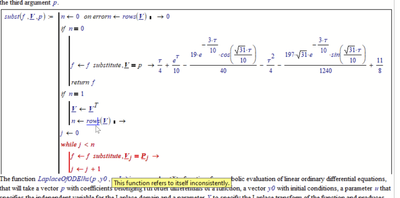

Unfortunately the sheet does not work in MC15.
The first error after manual calculation of the sheet is in "subst"
and when clicking that region, the symbolic evals of the transferred function is expanded, messing up the sheet.
The error is "This function refers to itself inconsistently".
A second error I spotted here
