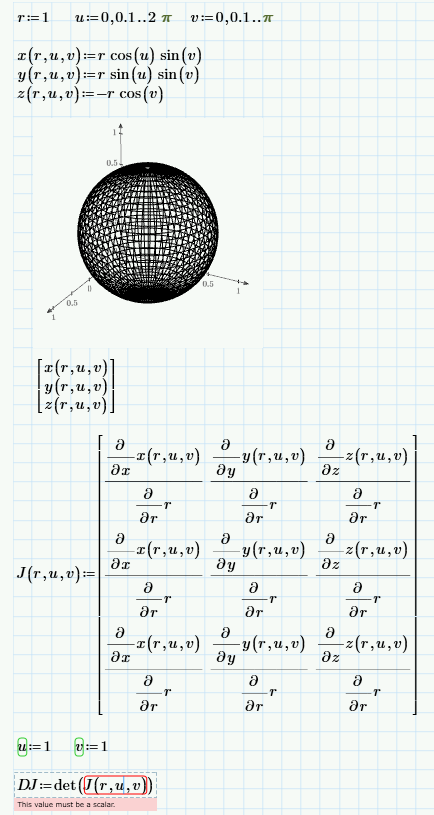

Hi everyone.
Im trying to calculate the det of the Jacobian however i keep getting this error.
Just what exactly does "scalar value" mean in mathcad? And more importantly, what can i assign u and v to fix this?
In my problem both u ∈ [0,2π] and v ∈ [0,π] but i dont know how to assign these values in mathcad.

Then see this, its your initial Mathcad file. Nothing I changed. You defined in a wrong way the Jacobian matrix...

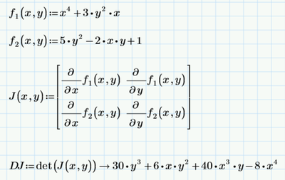

Here is an example:

Thank you. But can you explain to me why it works for you,but it dosent for me? I dont see any difference at the first glance,other then everything being re arranged.

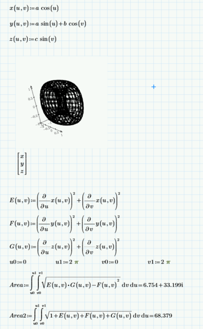

Oh i see, thank you. The problem is that i dont know how to define partial derivatives in mathcad. Is this also why i cant calculate the surface area of a bohemian dome?
Cornel
(To:MN_10921447)
I am not sure about these formula...

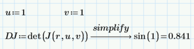

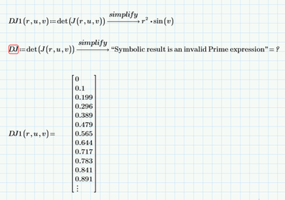

Sure you did (apart from correcting the Jacobian definition)!
You change the definition of u and v from ranges to simple scalars. Otherwise you would get the very same error message with the expression in the last line.
@MN_10921447
Apart from the correct definition of the derivatives in the Jacobian, the main "trick" is this:
Making the determinant a function dependent on r, u and v. Otherwise Prime tries to use the ranges which you defined at the top and fails with the error message you had seen.

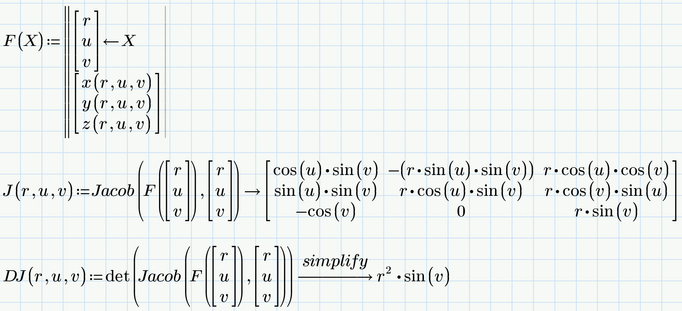

BTW, I would do without the u- and v-ranges and use CreateMesh for plotting the sphere:
and ... you could create a vector function and use the built-in "Jacob" function:
Its not necessary to evaluate symbolically, but it sure makes sense, I guess.

@Werner_E wrote:

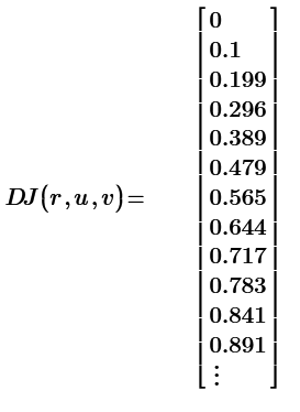

Yes, true. I didn't notice because from the beginning u and v were changed below in worksheet to scalars by MN guy. If u and v are changed to simple scalars then we can use:
Otherwise, if u and v are range variables then we need to use what also Werner said, DJ(r, u, v):

Oh, wow,I completely missed those too. Its unreal how much trouble one tiny oversight can create. Also i had no idea you can just do everything with vectors.
