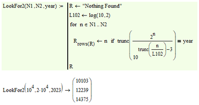

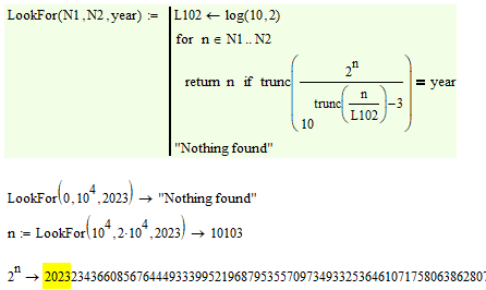

BTW, using brute force and Mathcads symbolic I found n=10103 to be the smallest solution for 2^n = 2023...
For at least the next ten years it gets easier 😉
A slight modification can bring up all solutions within a given range
MC15 file attached
MC15 file attached

The next two solutions are 12239 and 14375 and the powers end with ...9888 and ...3568 resp..
