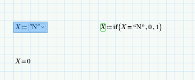

ppal
(To:SS_11608588)
Perhaps combo box
I'm curious on what the blocker is for your organisation to not upgrade to Prime 10 yet, especially since all of the controls like checkboxes were added in Mathcad Prime 10.
