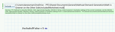

Silly, basic question - What is the green question mark in front of 'include' statements (Prime v11)

I can only find one question posed on this and the meaning of the green question mark wasn't provided. Nothing in the online help either. Mathcad also indicates that there are errors in the included document, but there aren't. Wasn't sure if the green ! was related to that.

So you can actually click on it to see what the green exclamation point is talking about. In this case, the worksheet settings (Calculation -> Worksheet Settings) between the sheet you included and the sheet it's included in are different.

Yes, I've seen the green box explaining possible differences to the user, but silly me, never connected that that was connected to the green exclamation point. To be clear, the exclamation point is not clickable, but the include box is and that's when the warning comes up. I guess the exclamation point is letting the user know that there is something to be investigated? Like I said, silly, basic question. Thanks

If you make the settings on the two worksheets the same, the green ! goes away.
