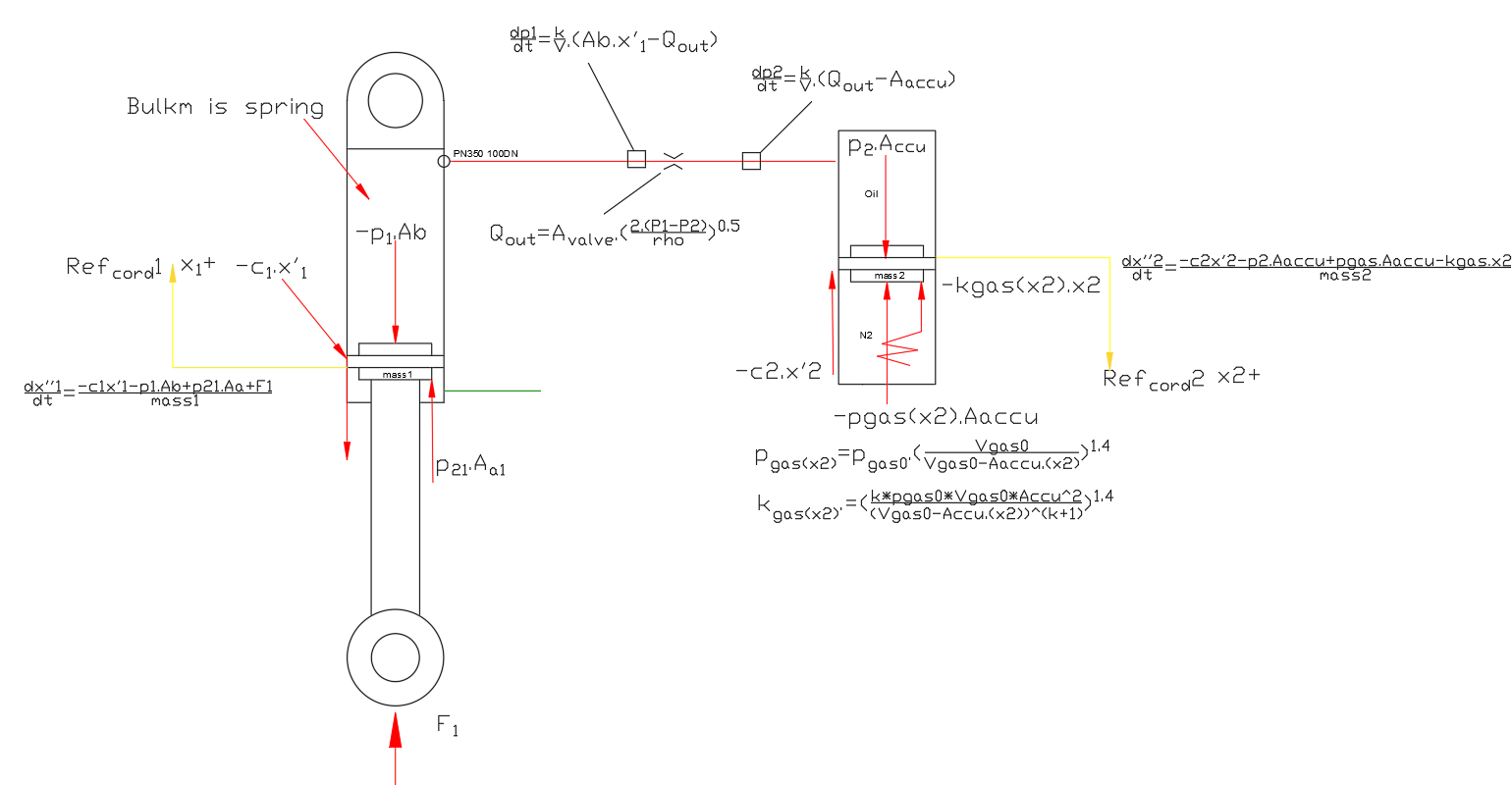

Good morning, everyone,
I'm currently working on a Mathcad sheet. I have two time-dependent functions that I want to combine with a differential equation. However, I keep getting an error message, and I'm not sure what I'm doing wrong.
I managed to get it working in MATLAB, but I would like to finish this properly in Mathcad. The issue occurs on the last page, where the solve block isn't isolated from the rest of the calculations
Does anyone know how I can solve this? Thanks in advance!

You do it exactly as you did 😉
And the name of the formal argument (currently x2) when you define function p.gas does not matter at all.
The error message is not helpful at all. The reason is a unit mismatch.
You defined p.gas0 to be 8*10^6, but it should be 80 bar. Actually I forgot to add the unit in the sheet where I tried to use units allover.
Not sure why this unit mismatch did not show in the sheet I posted - maybe because the else branch in the definition for x2'' never was called!?
I also noticed in that older sheet that the usage of function k.gas also would result in a unit mismatch even with the correct unit for p.gas0:
Anyway, in your new sheet k.gas is not used and once you add the correct unit for the initial gas pressure the solve block works OK.

1) You should use x1 and x2 in the odesolve command, not their derivatives.
2) p.gas is a variable (value 8*10^6) but is used as if it was a function here on the LHS.
This can't work
3) k.gas is here used like a function but its nowhere defined, neither as a function nor as a variable
The same undefined variable (k.gas) also occurs in the else branch in the definition of x.2''
Simply deleting the undefined expressions makes the solve block work, but sure that's not what you ar looking for. Of course x2 is constant zero.
I am not sure if the solve block will work using the branching (if ... else) on the RHS but as a first step you have to fix the problems with p.gas and k.gas.

Dear Werner,
Thanks again — I’ve made good progress due to you, and the system is almost working as expected. When I add an extra differential equation based on the conservation law (mass balance), everything still works correctly and behaves as expected. See the named working as the latest extension name in the attachment
However, when I try to make the gas pressure and gas stiffness explicitly dependent on the dynamic motion of x2(t), the model starts to fail. It simply stops working as expected. I’ve double-checked the free-body diagram. I know that in steady-state, the pressures should be balanced, so this behavior is unexpected
 I will try to solve this, maybe you have some tips. Perhaps the issue is due to the highly nonlinear nature of the gas-related functions (as shown in the appendix). I’m considering linearising the expressions for gas stiffness and gas volume to improve stability. It’s also unclear whether this inconsistency only affects the transient phase or if it also has an impact in steady-state conditions.

First of all, thanks again 🙏 for your earlier help — your tips have helped me understand what was going wrong and given me a clear direction to continue. I still plan to clean up the sheet properly myself, but right now I'm stuck on one specific issue related to the solve block and a position-dependent function. I have one small question, then I will stop stalking. If I want to link with the second mass spring damper, how can I do that? You already shared with a x, but this x is a vector linear and not linked with x2(t). Also, tried to use x2 and seems not to work. I removed the stiffness block and changed the < to > to test the ODE x2(t)
The gas pressure in the accumulator depends on the position of the piston x2(t) , and I’ve defined the gas pressure as a separate function outside the solve block:
But when I do this, Mathcad returns the following error:
"The target of an invocation has caused an exception."
Thanks in advance, maybe you’ll spot it right away.
Prime 10 sheet attached
