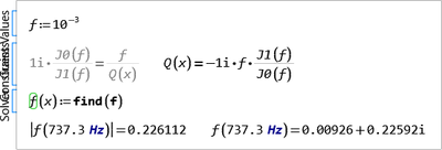

I have an equation like
Where Q(x) is some complicated complex function of x. This way f (or sol, if you prefer) is a function of x.
I would like to make x a range so that I can plot f as a function of this range.
Is it possible to do that?
(To:ptc-1681201)
Write sol(x):=... instead of sol:=... and delete the equal sign at the end of this expression.
Also delete the assignment x:=737.3 Hz.
That way you turned the solve block into a function of x.
You may also consider to use a non-real guess value instead of the 10-6 just to be on the save side.
Normally Prime will refuse to return non-real results if the guess value is real. In your case it works because of the factor 1i used in your equation.
Of course you could also use the name f instead of sol by writing f(x):=find(f). There should be no conflict between the function name f and the variable name f in the find function.

ptc-1681201
(To:Werner_E)
Thanks! It works (quite) perfectly. Very nice and very fast!
There are some numerical instabilities but they are at frequencies higher than those I take into consideration in my experiments.
All that is related to the study made by Prof. Munjal on lined (circular or rectangular) ducts, a study that I'm trying to use in my models for Transmission Line speakers.
Bessel functions mean circular ducts. Tomorrow I shall use the same technique to explore the corresponding equation for rectangular ducts (tan functions).
Thanks again!
(To:ptc-1681201)
As of the numerical inaccuracies: While you never can eliminate them completely when working numerically and not symbolically, it might be wort a try to experiment with different guesses and maybe also with different values for the system variables TOL and CTOL. Default value for both is 10^-3. Not sure if decreasing this value would help, though.
ptc-1681201
(To:Werner_E)
The numerical instability disappears by writing the equation differently:
Same for the equation to be used when dealing with a rectangular lined duct:
The original form was suggested in the Munjal book.
