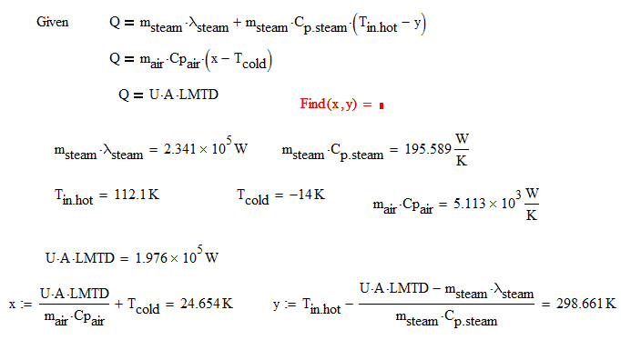

Hello! I am struggling with solve blocks in MathCAD, trying to make Given-Find too, not working for my equations.
Could you explain how it is working and how I can find solution to my problem?
I have 3 equations, 2 of them have 1 variable each(x and y), 3rd equation is for help...
See attached worksheet.

I'm not sure what's stopping your solve block; but your three constraints are actually two independent equations--you don't need a solve block
