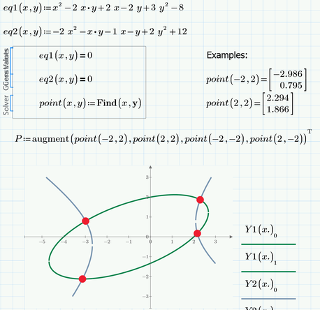

With input values you obviously mean the guess values, right?
You can turn the solve block into a function with the guess values as arguments.
Just attach your worksheet with the example solve block which you expect to return different results for different guess values.
(To:Werner_E)
Here is an example of what I was talking about:
Worksheet in format P4 attached
