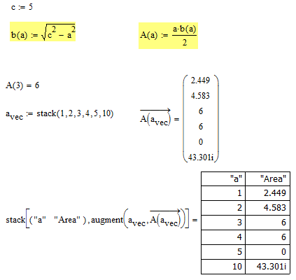

Its a long standing wish that we'd like to be able to turn a worksheet into a function but until now no development steps were made in this direction.
All you can do is to turn all your equations into functions depend on the variable you'd like to change. So at the end end you could call the final function  with a set (vector) of different input values.
I am aware that rewriting the 5-page calculation can be quite cumbersome and may also destroy the clearness/readability of the calculation.
Here is a very simple example of what I am talking about.
Instead of making the calculation straightforward
you turn them into functions of the changeable input variable a and create a table at the end:
Making the calculation depended on more than one input works the same way:

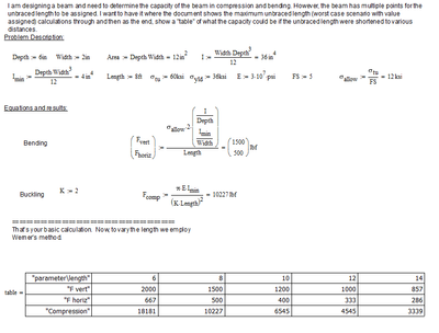

Thank you for your responses. They have helped however I may have been a bit too vague in my original posted question. Let me explain with a little more detail...
I am designing a beam and need to determine the capacity of the beam in compression and bending. However, the beam has multiple points for the unbraced length to be assigned. I want to have it where the document shows the maximum unbraced length (worst case scenario with value assigned) calculations through and then as the end, show a "table" of what the capacity could be if the unbraced length were shortened to various distances. I can do this by hand by changing my length dimension on top and it would auto-calculate and I can create my own excel table to have on my document however I was hoping there was a way that mathcad could do it for me.
Thanks again for your help.
LucMeekes
(To:eberg770)
You can still do that, if you put your calculation for capacity in a function with unbraced length as a parameter. Then you can have mathcad find the unbraced length that goes with e.g. the maximum, or any desired capacity. And the function will also allow you to calculate a table of capacity values for any list of unbraced length values.

As I already said there is no convenient way to do it. You will have to turn all calculations into functions which depend on the input variable you want to change.
My very simple example above should show how this must be done.
Would a graph do instead of a table.  Moment and Compression capacity versus effective length.
You will need to adjust the reference and input file names depending on where you place the files in the zip.
To design simply calculate the effective length look at a graph too choose the size..
Cheers Terry
We can do that, but not well:
Capture.PNGsee attached
