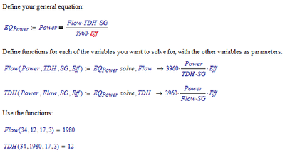

I would like to enter the equation into MathCad Prime 6.0: and solve for any one of the unknown.

Like this:

You should not worry about the error message. The variables are numerically undefined. But the symbolic processor doesn' t mind and solves.
If you look carefully you can see that mathcad 11 also complains about undefined variables, one of them is flagged red. So there's no essential difference between Mathcad and Prime in that respect.

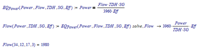

If you really cannot live with numerical errors, this should be the way out:
Define your equation similarly to the one in the Prime example; as a function:

I got this to work...and understand it.  Thanks... the root command should work well for all my equations.
I prefer the first method because it is more transparent to a third party.  It shows the equations solved for the unknown.  It also is less confusing by passing a guess.
