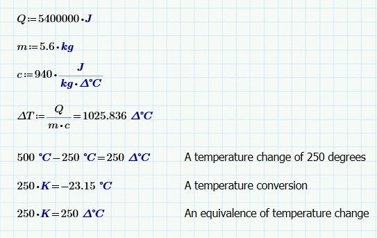

As shown in image I am trying to calculate temperature change. I think units are compatible but mathcad does not allow calculation. What is my mistake, I could not find. Could you help?

Hi
Try this:-
Cheers
Terry
2 REPLIES 2
Hi
Try this:-
Cheers
Terry
thank you very much for quick and accurate response. You are great!!!
