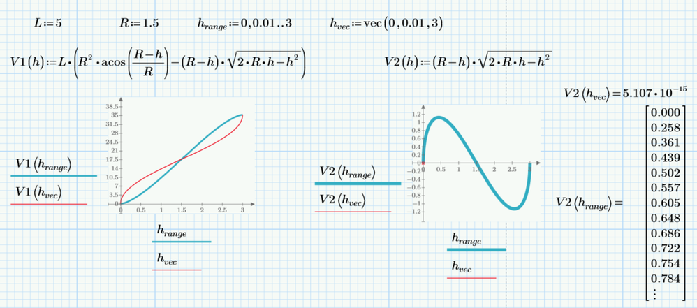

I have encountered some strange behavior with the new "vec()" function in Mathcad Prime 11.  An example of this is shown in the screen capture below.   In trying to plot a complex function (the volume of a sideways cylindrical tank), the old way with a "range" for the h in this example gives the correct results (determined independently of Mathcad).
However, the h created by the vec() function yields very different results in this instance.  I tried other simpler formulas [e.g, sqrt(2*R*h-h2)] and the results were satisfactory and both results matched.  But as I started fleshing out the equation with more terms, the behavior diverged as per the example below.   The other terms, when isolated, produce satisfactory results.  Only the term shown below in V2(h) presents strange behavior.  More still, expressing V2(h) differently (e.g., algebraically rewriting the expression will create still different but, likewise, still wrong results!

The phenomenon isn't strange. You forgot to vectorise the expression:
Certain mathematical operations are automatically vectorised. V2 isn't one of those. But with the acos added (V1) that part is vectorised. Observe the difference between:
And compare that to using the range:

I started making a more documented sheet as per your request and saw that it was indeed trying to dot-product the term that was not behaving as expected, but I had not played with the "vectorize" function in all the years I've used Mathcad.
As best practice, should this be employed whenever we pass an array to a generic function?
