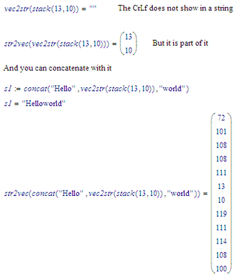

Hi Luc, I am not able to duplicate the CR LF trick. Other ascii code does work but not 13, 10. Could you provide me with a small worksheet that works so that I can see whether it is a computer setting or a misunderstanding from my side. I am using MC 15.050
LucMeekes
(To:FDS)
What is the problem?
tietjee
(To:LucMeekes)
Attached is a Prime 6 worksheet.
FDS
(To:LucMeekes)
Thank you Luc, my mistake was that I thought CrLf would show up. I should have done some further trying.
