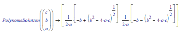

Unless your application is really complicated (showing a worksheet of what you are trying to accomplish will allow us to help you better), most such problems can be implemented by using the solve block as a function.
Here's an example:
You can even use it symbolically:

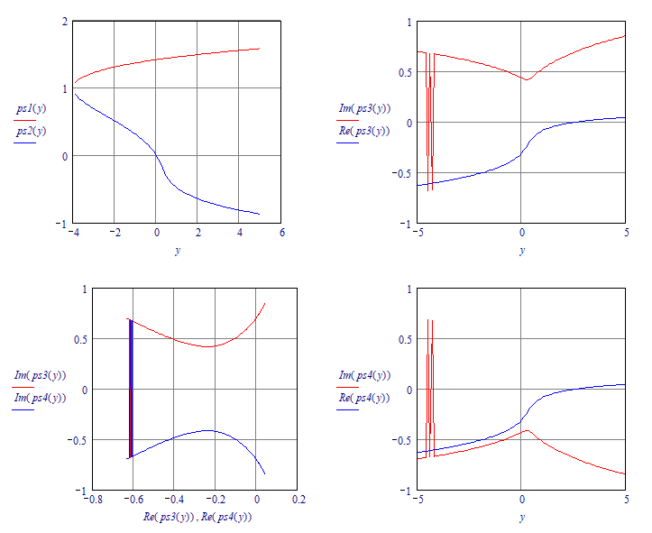

Mathcad/Maple finds there are 4 possible functions x(y), two are real, two are complex (have a real and imaginary part, they are (of course) complex conjugates. Below are plots from the symbolic solutions.
Changing the guess value to 0.5 doesn't change the plot in Mathcad 11, but changing it to 1.2 I get the upper solution (as shown by ps1). For a guess of x:=2, my plot also jumps. Given a real guess value, the (numeric) solve block can only find the real solutions. Apparently Mathcad 15's algorithm is more happy to jump between solutions than Mathcad 11.
(To:LucMeekes)
At least it behaves differently which was a little surprise to me as I was not aware of any major changes in the implementation of the underlying numeric algorithms.
