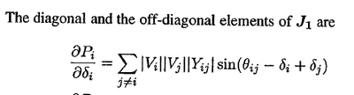

Hello everyone,
Im trying to construct a matrix in Mathcad Prime 4.0 for a Newton-Raphson power flow solution, but im having trouble defining the elements where a summation with j≠i is needed.
Is there any way to handle this in MathCad?
Thanks in advance
LucMeekes
(To:AS_11894200)
Simple.
Multiply the argument of the summation with (i<>j)
where <> is the unequal sign.
And if course you need nested summations, one over all i, and one over all j.

This worked perfectly, thanks a lot, I appreciate your help.
