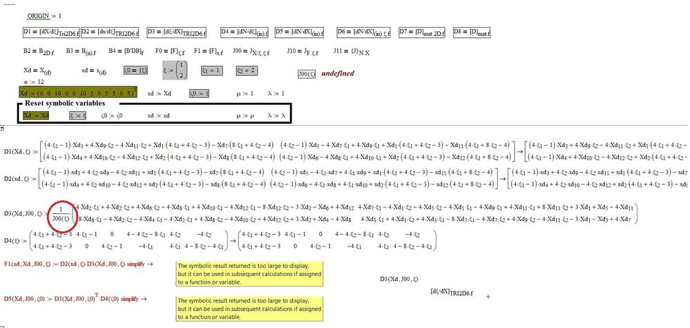

Yes, but I don`t need symbolic result which takes half of the screen and it takes time to make visualization.
Please look at my code I try to speed up some calculation. Symbolic calculation of functions improve performance but I can`t suppress symbolic results because the last function can`t be solved symbolically (:

It seems to me that your worksheet is overflowing with useless symbols such as subscripts with round brackets and in others the braces. The indices of the indicated variables do not go in brackets; did you invent this ->{ξ} ?, staples are not needed. ξ is an undefined vector.

ksi and {ksi} are the same, don`t worry about this, I use {a} for vector, [A] for matrix, if expression is very big I have to remove {} to reduce size of expression. The problem of my worksheet is the last expression can`t be done symbolically so I can`t suppress previous symbolic results as you and Werner suggested.

Everything must be solved, to improve performance I want to calculate functions symbolically but hide results. I need only the last expression which is numerical, it can`t be done symbolically. So, if I use bracket trick for all symbolical expressions I can`t get result for last one because, as I`ve already written, it can`t be done symbolically. So I have all input function for the last expression in red.

in the definition of  [dξ/dX].TRI2D6.f - you divide by J.X/ξ.ξ.f - but it is undefined. I think that it is the source of the delay calculations.

It`is not undefined, it`ll be passed to dksi/dX function as argument. Thank you and others. I understood the situation with this task. Don`t worry .
