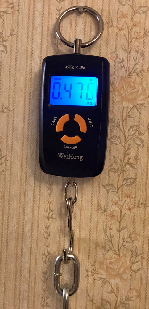

I once had an UK engineer use kg and Newtons in the same sentence, both referring to force (load cell rating).  And you thought our system was confusing.
Here must be newtons, dyne, gmf, kgf, lbf, ozf etc not gm, kg, lb, oz etc
We can use this device on Moon too...
I use it in airports! What is more impotent for aircrafts mass or weight of my baggage?
