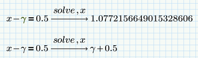

I've got a symbolic equation using the gamma symbol.  It seems that after performing a symbolic solve gamma is now one of the built in predefined constants - in this case Euler-Mascheroni's constant,    Is there a way to override this?    The gamma symbol is commonly defined in many other ways.
(To:DS_10024912)
When you type in your equation and you type gamma, Prime assumes you mean the Euler-Mascheroni-constant and labels it as being constant.
You will have to re-label it as "Variable" to overcome this.
If you look closely you can see that its labeled as "Constant" as it gets set in bold face and in a dark green color (at least thats the default - you can change the look of the various labels if you like).

Thank you so much!
