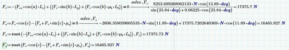

Mechanical engineering student here,
I'm trying to use MathCAD Prime 7 to solve for unknown variables in a linear equation using the symbolic solve function.
All I seem to get is the spinning yellow disc loading icon.
Can anyone help?
I have attached the file in question.

Just be patient you have done nothing wrong in your equations. Using root function is perhaps faster.

Hi
First I used version 10 on my fast PC and it solved in a few seconds.
Went to my laptop that has a version 7 on it and the orange wheels do indeed spin.

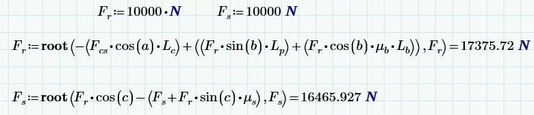

Used the root function method and solved in version 7 in no time.
Cheers
Terry
Thanks Terry, much appreciated. I will use the root function.
