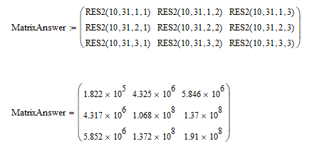

You cannot index a function at its definition.  Mathcad is looking for the name of a variable to index.
The second function definition does work as it does a number of summations that return a single value as a result of the function.
You can define a matrix that uses this function.  Is this what you are after?
Warning.  by default Mathcad indexes matrices from 0,0 unless you redefine ORIGIN worksheet variable.
Cheers
Terry
Cheers
Terry

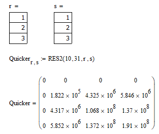

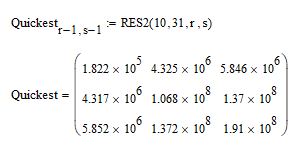

The answer would not be complete now we know the intent.
You can define the matrix with a quicker notation using the values of r and s you defined.
In this case a name is used in the definition so you can use indexes
Remember by default matrices start at index zero.
Cheers
Terry

This is exactly what I wanted, thanks !

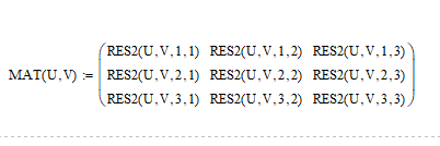

I want to have this :
where MAT(U,V) is a matrix (of function) and U and V are variables in scope for the MAT function. After, I will used this matrix for different values of U and V but for now I want keep U and V as vrariables.
My question is : can I do something like the print screen below?
Or do I need to define each component of the matrix MAT as it's done in the previous printscreen ?

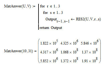

You cannot do this as Mathcad will not let you define a function with index values.
You either do as in your matrix method which gets cumbersome with big matrices..
Or use a small program to get around it.
Cheers
Terry

The solution with the for loop works perfectly  !
Thanks a lot Terry, It's really helpful.
