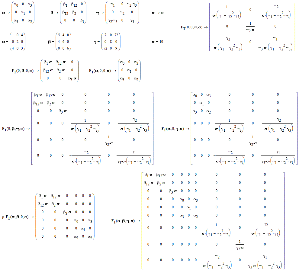

you could do as in the photo:
@-MFra-
One point, may be helpful to stress that makes my question diverge somewhat from your example. Writing f(y/x) does not necessarily mean that f(x,y):=y/x, but it means that whatever function f is, it is dependent from the compound variable y/x.
I absolutely agree with you. Typically, in Mathcad, when defining a function, the arguments of the function are comma-separated variables and operators are not allowed. However, this is only possible when the function is already defined and a numerical value is desired.
You can see an application of the technique I suggested, in the attached example.

I understand your comment.  In Mathcad you define a function with its operators.  If you define f(t) using t as a "dummy variable," with or without giving t a value, you can then evaluate f(y/x) for any instance where y and x have defined values--Mathcad will do the division and use that value to replace instances of t in f(t).
Separately you can define the ratio r = y / x and then calculate f (r).. Perhaps it is more understandable the small program, in the attached file, where only symbols are manipulated:
