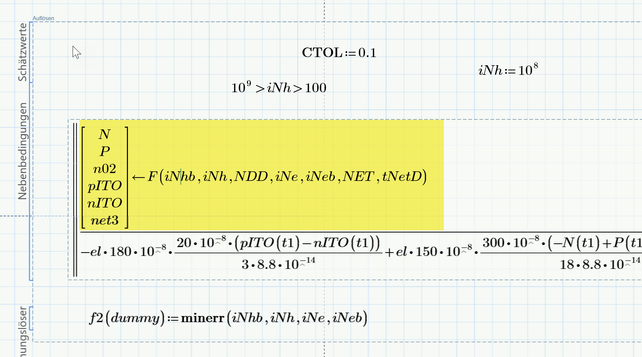

Your minerr-solveblock calls the odesolve-solve block (function F) six times for every iteration, which is quite inefficient.
The modification seen in the pic below should speed up the calculation by the factor 6.
I turned the solve block into a function just to be able to determine and compare the execution time of both versions.

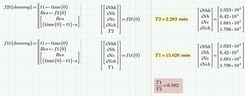

I just finished timing the two versions and the speed gain with my suggested modification is indeed a little bit more than factor 6.
P6 sheet (with auto-calc disabled) attached

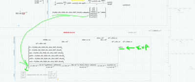

After I applied your solution to my main program. It still works slow.
I do not really see why. Maybe you could find it.
