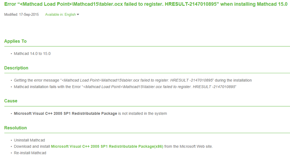

Hi Vladimir:  Thanks, but when I try to access the article it says I must have support services activated.  Trying to run that down, it seems that support cannot be reactivated on old permanent licenses.
So, the bottom line seems to be that if you have an old academic license, you cannot get any help breaking through the barriers placed in the way of moving your installation to a new machine.
(To:BD_3569427)
Thats correct and that may be the reason why Vladimir embedded the screen shot and also attached it as a png.
There is nothing more in this support article than you see in the screen shot. Basically it says that the error message you got is because you missed to install the necessary "Microsoft Visual C++ 2005 SP1 Redistributable Package (x86)". And, yes, its has to be that old version! The link to M$ doesn't work any more, but searching for the pack in the net should bring up a couple of links where you still can download it.
