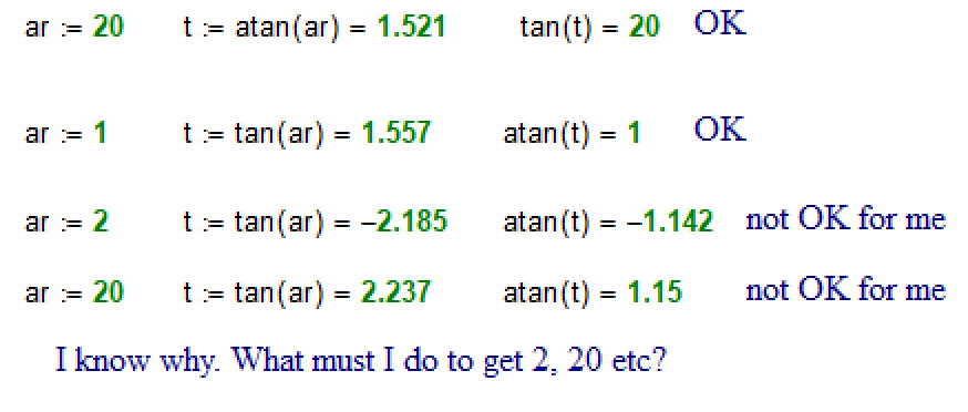

Tan-Atan
ValeryOchkov
Tan-Atan
Cannot be solved.
The tan function is periodic. A one-to-one relationship exists only if you limit the argument of the tan function between -pi/2 and pi/2.
In your 3rd and 4th lines that is not the case.
You'll find the very same problem if you change 'tan' to 'sin' in your expressions.
For 'cos' it is slightly different.

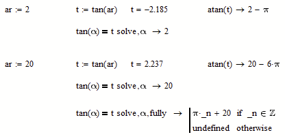

Cannot be solved.
I see
If you use tan(..) then a lot of information about the angle is lost and can't be brought back.
The atan function is not the true inverse of tan but is limited per definitionem  to the range [-pi; pi] to make it a unique function.
But if you don't use numeric inline evaluation when calculating t, symbolic solver "remembers" where it came from - at least as long as ar rational and not given as float value.
In real Mathcad you can create your own atan-function to do the job:
But it will only work if you evaluate it symbolically 😉

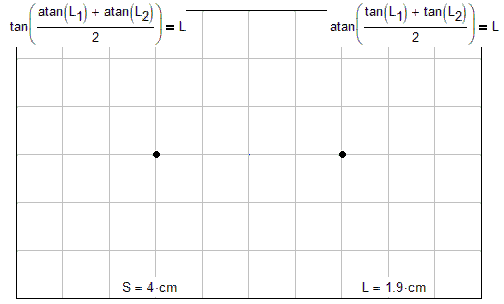

I will show one solution fpr one my problema with ovals!
Now I am creating the animation!

My solved problem with tan and atan
Trigonometric ovalsTrigonometric ovals
