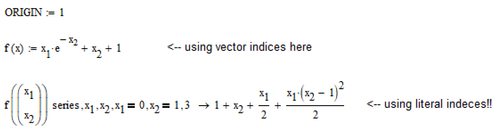

I don't think that the series expansion can be done using a genuine vector x as function argument.
But you may do it using scalar arguments with literal indices:

Addendum:
You can define the function using a vector argument and vector indices, but when it comes to the series expansion, you must (unfortunately) use literal subscripts.

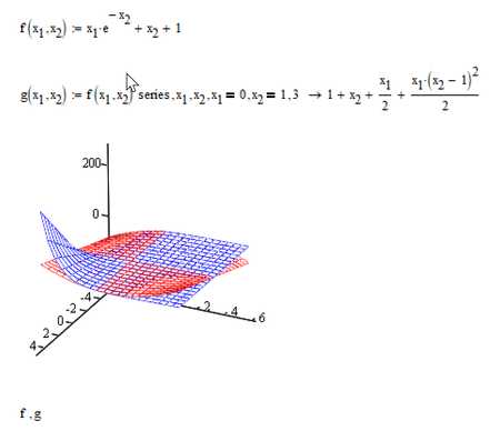

This is what I get in Mathcad 11:
