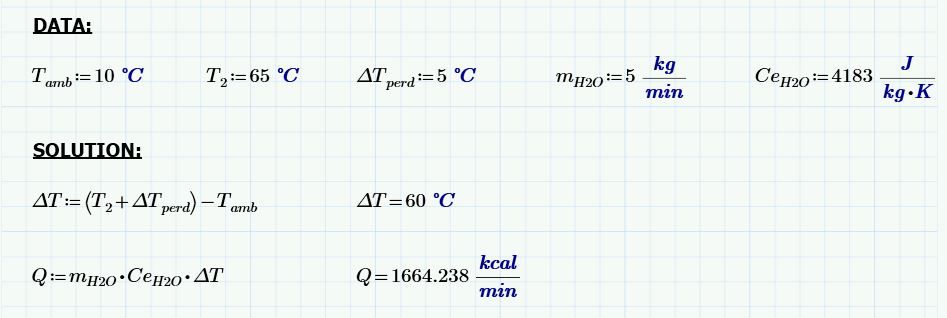

Hi everyone.
I am doing a simple calculation, but I have problems in the temperature units, which generates erroneous results.
A quick solution in this case would be to work the temperature without units. However, is there a way to work with units in this type of equations without getting wrong results?
Thanks for the help

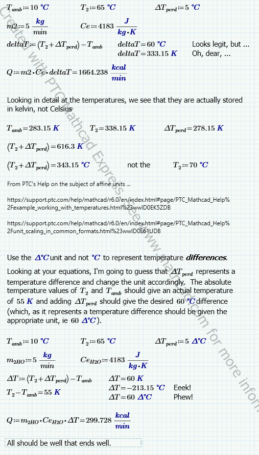

StuartBruff
(To:BPP)
I haven't got Mathcad available at the moment to check, but Mathcad internally stores temperatures as kelvin. Consequently, your T2+Tperd will be about 338 K + 278 K = 616 K, giving deltaT = 333 K (which is about 60 deg C).
You need to take this into account. There is a ways of dealing with this in unit, but I can't remember what it is ... look it up in help?
Stuart

StuartBruff
(To:BPP)
Here's a confirmatory worksheet ...
Great. Thank you very much Stuart.
