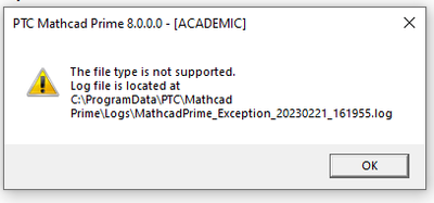

Unable to open the file, pops up a warning that the file is not supported.
please help

Sorry, my first guess was that you tried to open a file of the current version P8 using an older version of Prime.
I looked at the file and its a damaged corrupt archive (Prime mcdx files are just renamed zip archives).
I was able to save some of the contents, but there seems at lot to be missing, amongst them all pictures. I could recover most pictures but wasn't able to get Prime to use them in the file. So I attach the pics in a separate archive (media.zip) along with the mcdx file.
Maybe someone else has more luck in recovering the file.
Thank you, I can easily find the photos again, it will spare me a lot of work. Do you recommend that I always use save as, so if this happens again I can get the earliest version instead of redoing everything, or is this a rare case?

BG_10572849_0-1676992831940.png-----  It also happened to another assignment I was working on yesterday, Maybe a coincidence but I saved both of them yesterday and now the same thing happened to both of them, Is there something I did wrong, and why is this happening?----
file location : C:\ProgramData\PTC\Mathcad Prime\Logs\MathcadPrime_Exception_20230221_161955.log
Build Number : 2022.03.01.001
System Culture : en-US; Current UI Culture : en-US
Architecture: x64
Application version is: PTC Mathcad Prime 8.0.0.0
Current license type is: EducationSub
Exception data:
File being opened: G:\My Drive\DTU\Vorönn 2023\41965 Wood Structures Spring 23\Verkefni\Assignement 1\Assignment 1 - Wood structure - BFG-1.mcdx
FileFormatException when processing file
System.IO.FileFormatException: File contains corrupted data.
Maybe you are not doing anything wrong apart from using Prime, a software that, despite a development time of a dozen years, is still not mature enough to hold a candle to its predecessor Mathcad.
We often read here in the forum about corrupted Prime files and its quite difficult to repair them and its also unclear, why saved files sometimes end up damaged.
Even with legacy Mathcad it happened occasionally (much more rarely) that corrupt files occurred. However, the error message when trying to load was much more helpful for a repair and, moreover, thanks to the autosave function available there, it was usually possible to continue working with a fairly current backup that was automatically created in the background.
Prime has no such function and I find the messages in the log unhelpful when trying to restore an executable file with as little missing as possible.
