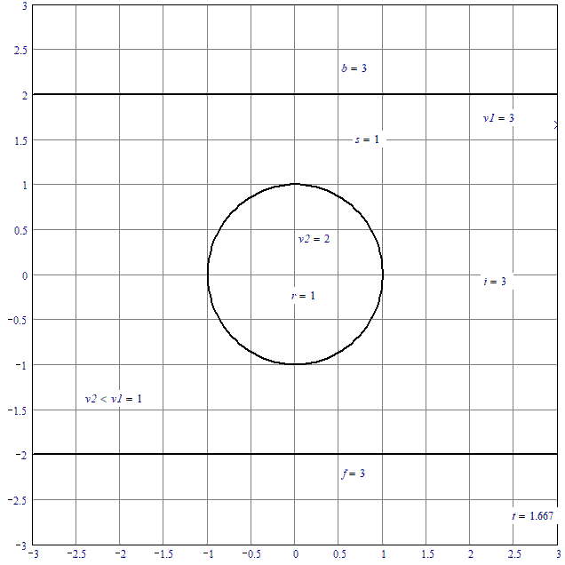

More correct Mathcad 15 sheet for v2>v1.
My egg head cockroach is waiting the solution for v2<v1

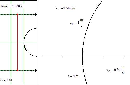

So, I rebuilt the system, cleaned the bread crums away from the circle, and got the silverfish to also explore the dark places:
And I also reversed the speeds, but that really confuses the silverfish:
So there's more work to be done.

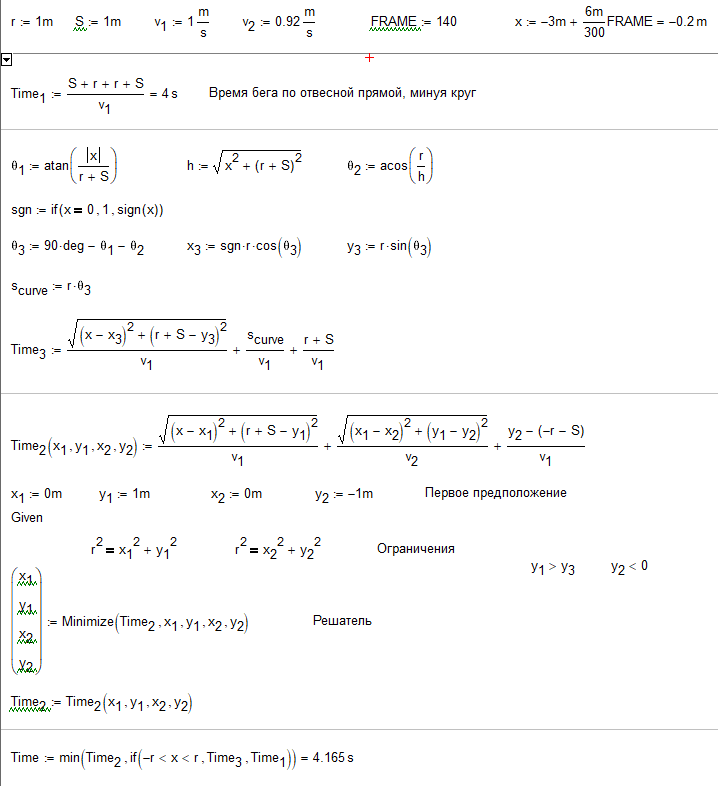

Valery,
To include the possibility of v2<v1, I think you just need to add one more case (Time3):
  • Travel from (x, r+s) to the tangent point on the same half of the circle (left tangent point if x<0; right tangent point if x>0; runner's choice if x=0).
  • Follow the curve to (-r, 0) or (r, 0), as appropriate.
  • Travel straight down to the finish line at either (-r, -r-s) or (r, -r-s)
Note that Time3 is only applicable for -r<x<r.
The minimum race time would then be min(Time1,Time2,Time3) regardless of if v1<v2 or v1>v2.
I'll leave the math up to you.

OK, curiosity got the bettor of me.  It was a little more complicated than I originally stated.  Note that I had to add a couple constraints to your minimize function.
Sorry for lack of notation on my new calculations.  I don't even know what your Russian notation even says.
Animation (thanks, Luc):
Mathcad attached.

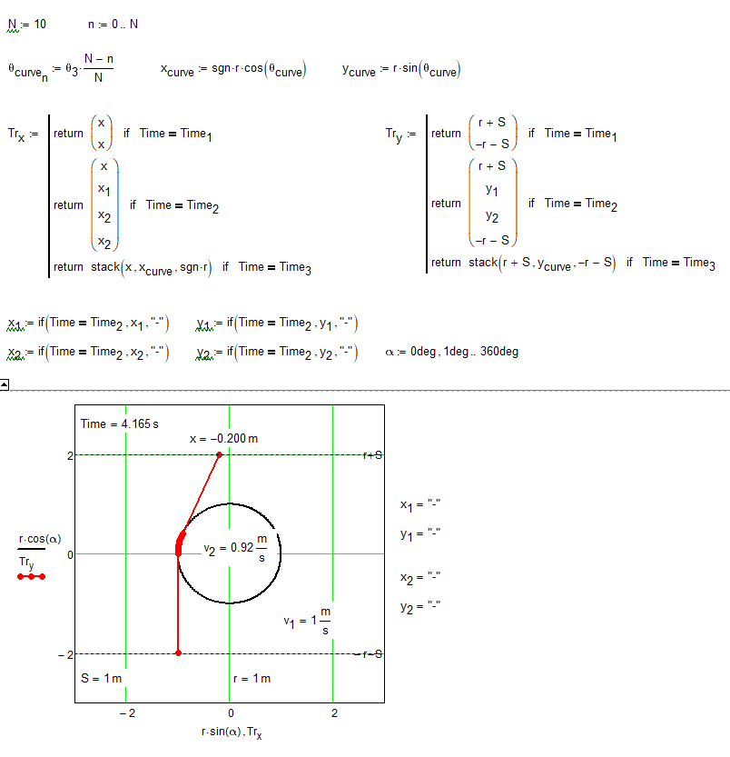

Valery,
Your last image includes a "?"  I'm not exactly sure what your question is.
The curved line in your image is the path corresponding to my Time3 calculation.  My method of graphing this was to approximate by using 10 line segments.  With some extra effort, you could get mathcad to draw the actual curve.
Hope that helps.  If not, let me know what the question is.

I guess Valery is wondering if, considering the small ratio in velocities v1 and v2, it would not be faster to run the straight line with the somewhat lower speed, than to run the rurved line, at the slightly higher speed.
Note that the straight line between the two points on the curve is always shorter than the curved line.
There must be some (angular) distance between the two points where the run time along the straight line gets lower than the run time along the curve. And yes there is such an angle. But i guess that angle is such that at that moment it is faster to run across the circle, past the horizontal mid-line.
You can see that ts<tc when phi > about 0.4. That's quite a large angle!
