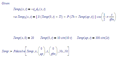

I have a problem : I want to analyse the thermal heat evolution of a wall with fluid heat variation. Can you help me ?
Thank you.

You have two constraints for Phi_d(x,t):
With 'Flux' it is equal to:     -a * Temp.x(x,t)                    which may be a function of t AND x
With 'Cond. aux limites':    Phi_h_S(t)-Phi_h_P(t),        which is a function of t, not of x.
If I define:
I can:
Then the solve block becomes:
So you have two different constraints for Phi_d(x,t), but you could also state:
Which leaves Phi_d.x(x,t) undefined, and that might explain why I get an 'undefined variable or function' error message.
If you could set initial conditions for Phi_d(x,t), you might be able to solve for Temp and Phi_d simultaneously.

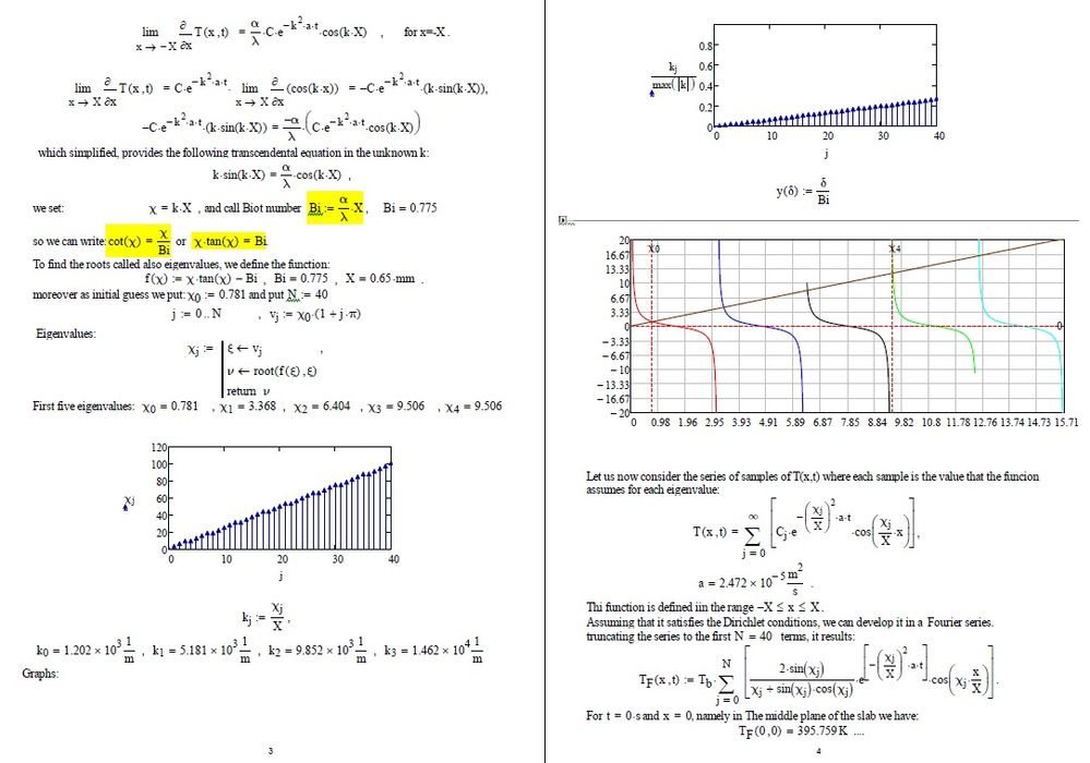

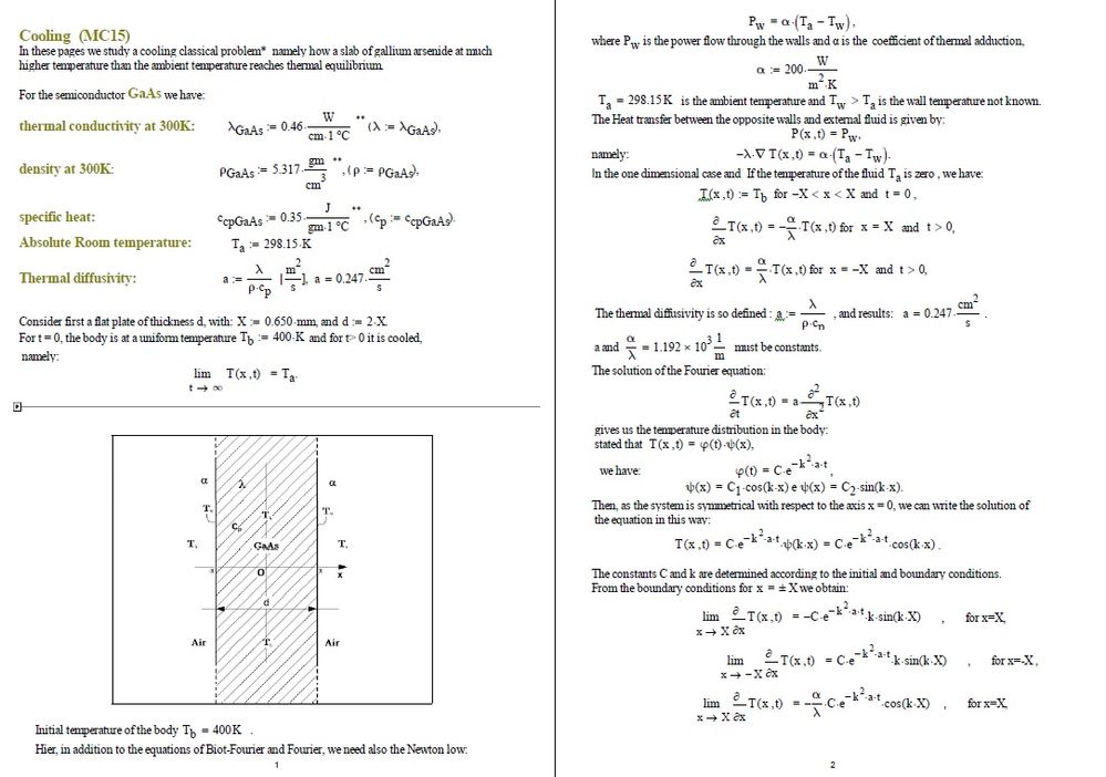

I publish something about the cooling. I don't know if you are interested:

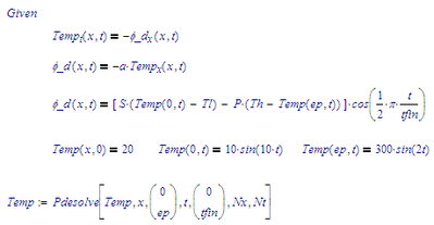

How about the attached?
You have weird boundary conditions though:  one end varies from -10 to +10, the other from -300 to + 300.

I am very interested in all yours responses. Thank you very much for spending time helping me for this problem. The data being confidential, I had simplified the functions, which could have made the subject less comprehensible to you. The thermal exchange and boundary condition functions are described with very severe transients. now I will put in practice your precious advice.
Thank you all.
