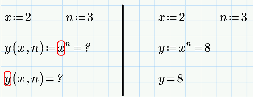

Either delete the equal sign at the end or delete the "(s)" after T
You have to decide if you want define a function T() (no "=" at the end!) or if you want to define a variable T
This is an old mistake, or rather a flaw.
Once upon a time, the developers of Mathcad created the tandem-operator ... := ... = ..., but forgot to attach it not only to variables, but also to functions. And the error messege is not correct.

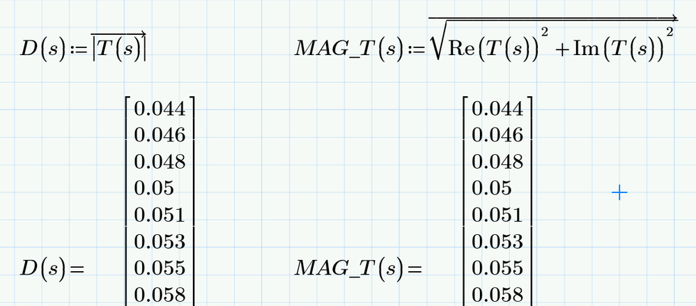

I defined D(s):=|T(s)| and vectorized on top of the |T(s)|, then I evaluated the D(s) expression and it seems correct.

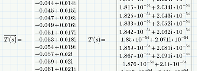

However, when I try: MAG_T(s):=[(Re(T(s))^2+(Im(T(s))^2]^0.5 returns values around 10^-54 which is a very low number and its results do not match with D(s):=|T(s)| vectorized which returns around 0.06 or so
Do you know why?
Please see attached file
Thanks for your helps again
Do you know why?
Yes, I do.
Valery already showed the solution - you have to vectorize the expression.
The reason is the difference between T(s) and T(s) vectorized
Why the difference? Because of functions like z.d1(s). They include z1(s)*s. z1(s) returns a vector and s is a vector. So without multiplication vectorization you get the vector product. This is not what you want - you want to feed every single element of s in your function and collect the scalar results in a vector. And this is exactly what vectorization is good for.
