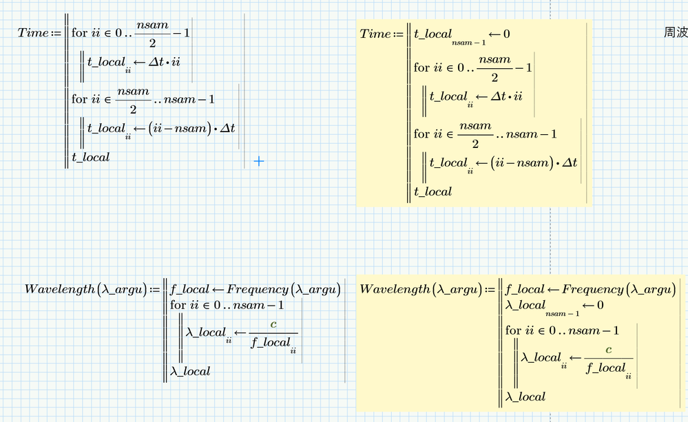

You initialize the arrays by setting the element with estimated or known last index/indices to zero before assigning any values to the array.   This minimizes the time Mathcad spends adding new elements to a dynamic array.   For most purposes it makes little difference.  However, it can give some time savings for large arrays.   This was more of a problem with early versions of Mathcad running on the much slower PCs of the era.
Here are a couple of examples from your worksheet:
Some other small savings may be made by precalculating some of Fourier Transforms.  When indexing CFFT(ee_in)j, for example, Mathcad will evaluate CFFT for each j.

I hope that gives you a starting point for improving the worksheet's performance.
Stuart
