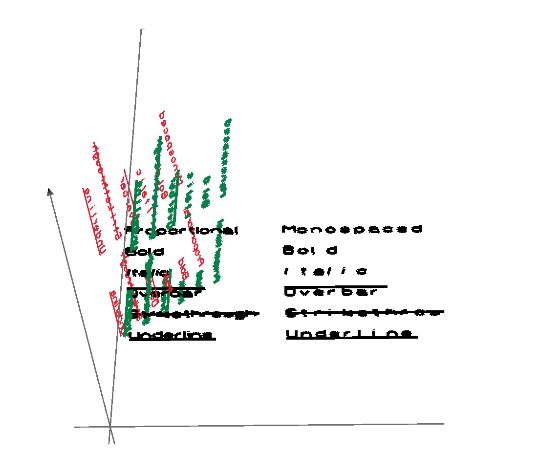

Attached is a Prime 4 file that allows you to plot text in a graph, like:
Of course it runs in Prime Express...
Enjoy!

Nice, but I would write your 3D functions as:
There's no need to add an additional NaN bar at the top, because there is already one.
It's also fully ORIGIN aware.
Besides this function also works in Prime Express (The 3D plot unfortunately not 😞 ).

Thanks Luc. I try to change ORIGIN=1 then Prime 7 shows error. May be your function below corresponds. T.Tokoro.
LucMeekes
(To:ttokoro)
You're right. There's an error in one of my functions. I'll try to find a solution today.
Thanks!
LucMeekes
(To:LucMeekes)
Corrected errors that prevented it from working with ORIGIN values other than 0.

I just noticed some annoying extra points (which don't show when no Symbol is selected as they are separated by NaN's.
Especially the one at the lower left is a problem when trying to determine the width and height of a text in an attempt to center it because its independent from the text's starting point. It also may interfere with Primes autoscaling of plots.
I stumbled upon this when using text at starting positions very large and wondered why my attempt to determine the width of the text failed and returns much too large values (centering then throws the text way off the left margin of course).
I guess that the first two pair of values (scaling and starting position) are necessary when the data structure it used as an input to modifiers like Bold or Italic.
Probably the only solution is to cut off the first four or five rows and maybe also the last two after all modifiers are applied.
LucMeekes
(To:Werner_E)
Hi Werner,
Thanks for pointing that out. I think it's corrected now.
