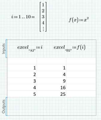

Trouble exporting function results to Excel, keeps saying "This value must be a scalar or a matrix"

Illustrative file attached.

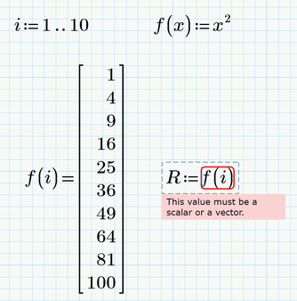

The problem in fact is not the function but its argument. i is a range and a range is NOT a vector but rather some sort of implicit loop. So f(i) is neither a range nor a vector - its kind of an invalid object suitable only for display. You can see this if you try to assign f(i) a variable:
But what you did works OK if you turn "i" into a true vector. The simplest way to do so is by using an immediate inline evaluation after the definition:
But that method of turning a range into a vector is undocumented and so is subject to be changed without notice.

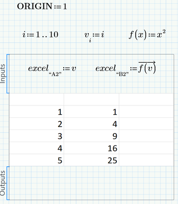

So a more "legal" way could be this
Note that I use vectorization when I call f(v).
You will see why when you change the x^2 to x*x in the function definition and don't use vectorization 🙂

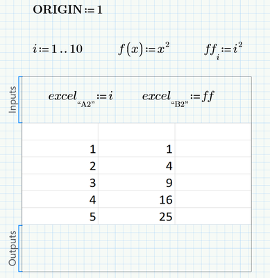

I just figured it out. I had to create a new function that returned an array. A bit uglier now in my opinion. I mean the original function returned the same matrix and values (see below) but does not work? Silly IMHO
