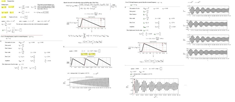

-MFra-
(To:prop_design)
I have adapted your data to a sawtooth excitation with an adjustable duty cycle. What do you think?

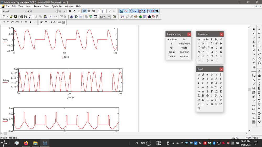

i am working on some changes to make it easier to work with beats. this was an input type posted by a different user earlier. i was looking at resonance and he was looking at beats. the file isn't finished yet, but i got a wild response while testing random inputs. check this out. pretty crazy. those are velocity, kinetic energy, and acceleration. the kinetic energy plot is the wildest looking one. i'll post updated files once i get them done.

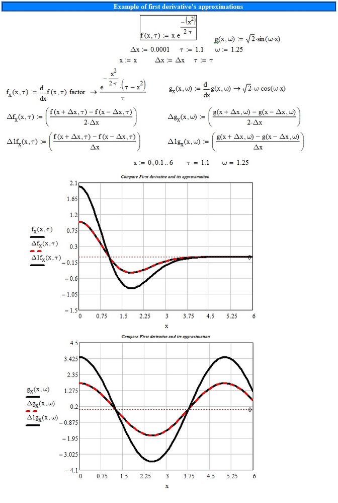

I have not elaborated on the approximations that you have made. However, with regard to the first derivative of a function and its approximation, we must be careful, the following graphs highlight this fact:

hi there,
thanks for looking over the examples. i'm not sure i follow you. as far as i know the method i used is producing the same results as the built in derivative and second derivative functions. that is what is in the comparison files. however, the built in functions become extremely slow. sometimes you have to use different methods as well. so i think manually doing it is better. i don't see a problem in the files i created. but if you do, please let me know. you can message me here as well. i did have to do one thing different than i normally do, to match mathcad. i had to use a forward point and a backward point. i usually just use backwards points. but i still didn't see any issue.
note; on the comparison files you might want to change the inputs, so you don't have to wait so long for the built in derivatives to complete. i think i have some of those files setup in a way that makes it take really long. my laptop fan goes nuts while it solves those files as well.
thanks,
anthony
prop_design
(To:-MFra-)
i'm not sure if this is what you are referring to or not. the definitions of forward, backward, and central derivatives. it looks like mathcad is using a central method. i usually use a backward. so i tried to adapt to the central with the provided data. however, technically, you would have to compute points that aren't in the matrix.
https://theailearner.com/2019/05/24/first-order-derivative-kernels-for-edge-detection/
the agreement i was seeing was good though, so i didn't mess with it further.
edit; oh i think i see what you are saying. on your plots, i'm not sure what curve is what. maybe you could change the color of one of the black lines. but i see how the terms cancel and you are left with a divide by 2 that i don't have. i'll look into it more.
edit 2; hmm. adding the divide by 2 introduces a big difference and doesn't agree. so i'm confused now. perhaps message me and we can figure it out. i'm not sure i understand what you were showing. also, not sure why the central difference is different by a factor of 2 to the mathcad derivatives.
edit 3; ahh. what i have is the central difference equation. without the divide by 2. because the delta time is the 2h term. so i think what i have is right.
