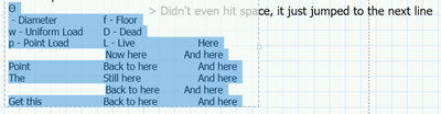

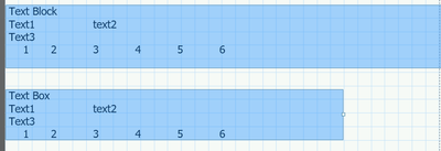

This is what a text box and text block with several tabs look like in my Prime 10:
Here's a text block example
Both the first and last indented lines are tabbed over 8 times, they should line up with the "L - Live" above it, yet they don't even line up with each other
And a text box example
Exact same font, size, and number of tabs used as above, this time the first and last indented lines at least line up with each other
Also, on the first line I typed Θ (Alt+233), which worked fine in the text block above, but jumped down to the next line in the text box below.
I have not been able to reproduce the adding multiple tabs when I single tab, or the adding a new line after "X", but I'm doing this with a freshly opened file, so it could be something where errors start propagating the longer the document is open and being worked on.  I'll try to share screen shots and more details if/when they do come up again.
