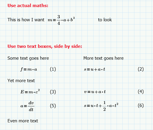

This might not be totally satisfactory, but:
(To:RB_13829612)
Unfortunately the answer to both of your questions may be "no". You can't change Prime behaviour concerning text editing.
But I can't see that Prime would indent the whole line if you press <Tab> after an embedded Math region. The cursor moves to the next tab position (which can't be changed to your needs) and all text and math regions AFTER the cursor move along. and are shifted to the right. May not be the standard you may expect and there is no "insert/overwrite" option which you could turn on and off.
Prime is way back behind programs you may call current standard.
What you experience may be called minor nuisance compared to other design catastrophes or missing features.
Generally I very much dislike using math regions inside of text regions or text blocks a lot as it makes editing and working a lot more difficult.
Old Mathcad had a simple feature which allowed to vertically and/or horizontally align regions, but Prime is missing this feature so you are own your own moving the regions so they snap nicely to the grid the way you want them.
BTW, its easy to accomplish what you show as an example
After the math expression a:=3  I had to hit <TAB> a few times to get that far to the right (as I already said, tab stops are not customisable).
The line starting with "Some more text" was automatically indented and so I had to use the Backspace key to get to the left.
Once the text block is already created, <TAB> seems to act differently and jumps from math region to math region and you would have to use <SHIFT>+<TAB> to insert a new tab space.

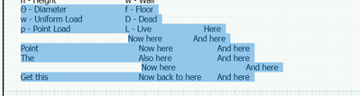

Here's a text block example
Both the first and last indented lines are tabbed over 8 times, they should line up with the "L - Live" above it, yet they don't even line up with each other

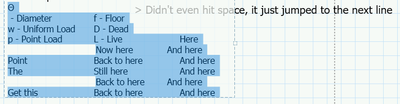

Exact same font, size, and number of tabs used as above, this time the first and last indented lines at least line up with each other
Also, on the first line I typed Θ (Alt+233), which worked fine in the text block above, but jumped down to the next line in the text box below.
